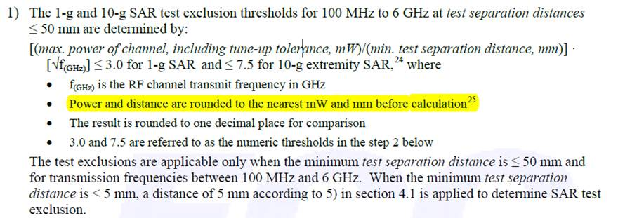

Would like to hear from others about their experience getting through FCC/CE Mark relative to SAR (Specific Absorbtion Rate)  testing on Bluetooth.
I am interested in portable products that would be located right up against the user's body/ear.
There are of course plenty of BT hands-free devices that sit on your ear.  These all tend to be Class 2 (low power) Bluetooth and so they probably get an exemption on SAR testing.
Is it possible to get approved with a Class 1.5 (like CC256x) or Class 1 device ?  Can anyone point me to such approved devices.  And certainly if you have been through the process please pass along some description of Cost/Time involved.
I believe it should be possible since WiFi on cell phones operate at comparable power levels to Class1 Bluetooth.  But being DSS, they perhaps get different treatment in terms of SAR.
