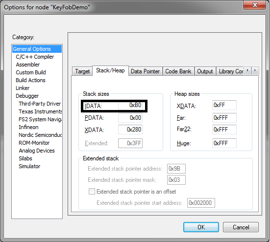

am working on cc2540dk-mini. i have opened a sample program of heart rate in iar environment. during make process it shows one error "error while running linker"...
how can i solve it...

  • Building configuration: heartrate - CC2540DK-MINI Keyfob Slave
    Updating build tree...
    Linking
    Error[e16]: Segment ISTACK (size: 0xc0 align: 0) is too long for segment definition. At least 0xe more bytes needed. The problem occurred while processing the
    segment placement command "-Z(IDATA)ISTACK+_IDATA_STACK_SIZE#08-_IDATA_END", where at the moment of placement the available memory ranges
    were "IDATA:4e-ff"
       Reserved ranges relevant to this placement:
       IDATA:8-1f           VREG
       IDATA:21-40          VREG
       IDATA:41-42          XSP
       IDATA:43-43          DATA_I
       IDATA:44-4b          DATA_Z
       IDATA:4c-4d          IDATA_Z
       IDATA:4e-ff          ISTACK
       BIT:0-7              BREG
       BIT:80-97            SFR_AN
       BIT:a0-af            SFR_AN
       BIT:b8-c7            SFR_AN
    Error while running Linker
    Total number of errors: 1
    Total number of warnings: 0
    this is the error am getting...
    i hv just select the workspace name(CC2540DK-MINI keyfob slave) then project menu-> make
    Got same error on my side.
    The issue is IDATA stack size. IDATA stack size is  more, so it's taking memory from other segments.
    To solve this, goto project->options->general options->Stack/Heap.
    change stack size of IDATA to 0xB0.
    Look :
    This should solve your problem.
