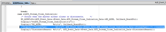

now, i want MSPAUDSINK demo , "A3DPDemo_SNK project ", at thr IAR Workbench 6.10.5
but i can't not build, error occur. TT
i open workspace
C:\ti\Connectivity\CC256X BT\CC256x MSP430 Bluetopia SDK\v1.5 R1\MSP430_Experimentor\Samples\A3DPDemo_SNK\Projects\IAR\A3DPDemo_SNK.eww
and change to debug-A3DP SNK Board
and Build all
and below is error message
Error[e16]: Segment DATA20_C (size: 0x1d21 align: 0) is too long for segment definition. At least 0x1d more bytes needed. The problem occurred while processing the segment placement command
"-Z(CONST)DATA20_C,DATA20_ID=4400-FF7F,10000-243FF", where at the moment of placement the available memory ranges were "CODE:226fc-243ff"
Reserved ranges relevant to this placement:
4400-52b9 DATA16_C
52ba-536f DATA16_ID
5370-539f CSTART
53a0-54d3 ISR_CODE
54d4-ff7f CODE
10000-226fb CODE
226fc-243ff DATA20_C
what is problem?? plz help me
