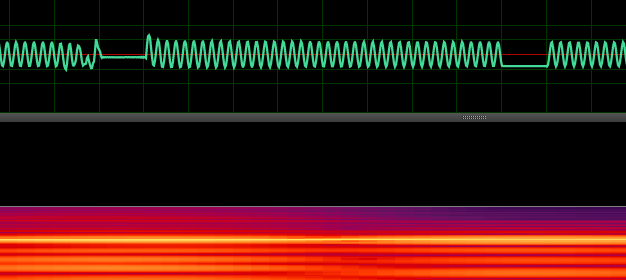

I use LBMA1BGUG2 cc2564 (not cc2564a and cc2564b) for my bluetooth application. and i use pcm interface to connect BT module with cpu.
The audio quality is extremly poor on HSP, and at the same time I use arecord to record the wave file, and i use analysis tool to open this file, and I found the recorded wave is not continues, so i guess that the pcm interface has lost some packets.
the pcm mode of BT module is i2s slave, and the the clock rate is 256KHz and the frame clock is 8KHz.
Please help me to reslove the issue, thanks
