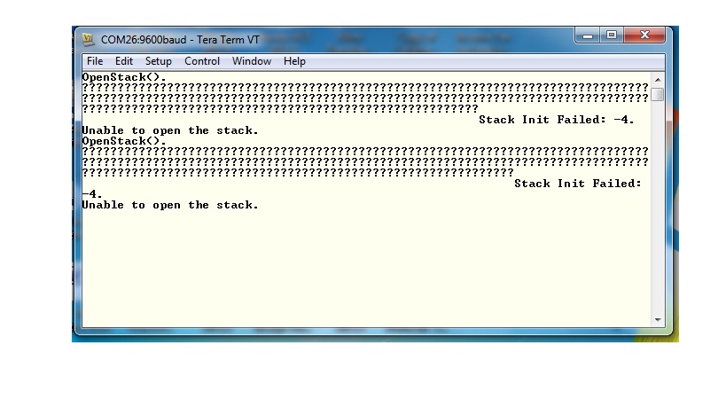

We have made cc2564mod based board(CC2564mod including level shifters)and for testing using MSP-EXP430F5438 experiment board and the SPPdemo sample code.
i have ported stone street SPP Demo on MSP5438A. when i reset the module and monitor UART com port 5 with 9600 8n1, it is showing
stack init failed -4.
unable to open stack.
Please let us know how to debug the issue as I am not able to see in debug mode exactly the issue because the code jumps to DisplayFunctionError("Stack Init", Result); after Result = BSC_Initialize(HCI_DriverInformation, 0);
Please do the needful.
