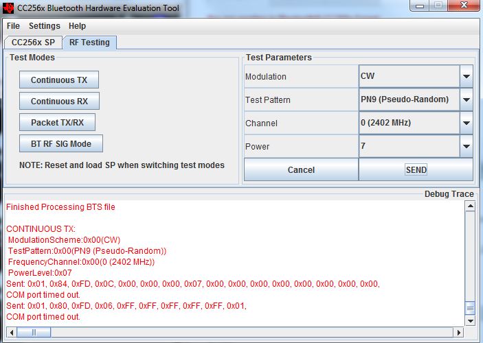

I want to test the RF Output Power of the CC2564 on my own design. So i flashed the MSP430f5438A with the Transparent Mode Example.
When connecting with the SmartRFStudio 7 and load the SP (bluetooth_init_cc2564B_1.0_BT_Spec_4.0.bts) I want to set the RF output Power.
Now the comes an timeout error in the communication window (see attachment) and the CC2564 put out a power of -19dBm. When selecting the max.15dBm there is a power of 12dBm
