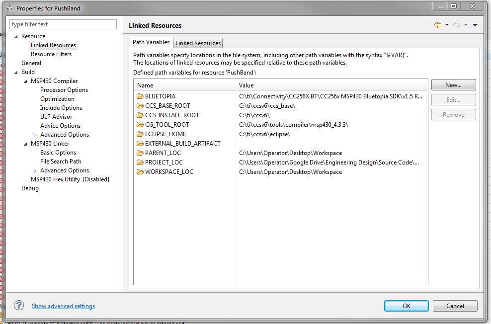

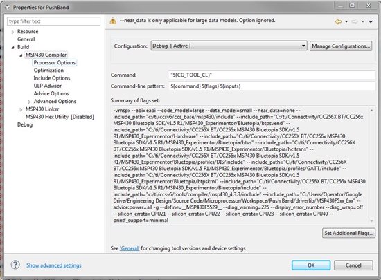

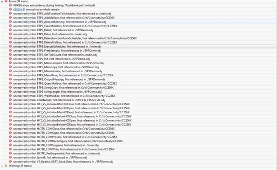

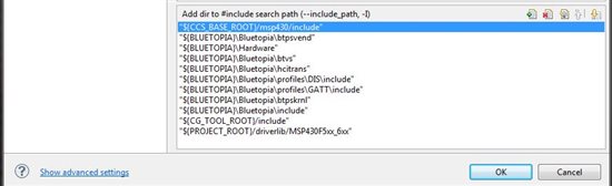

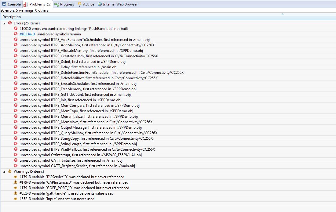

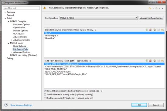

I am trying to use the Bluetopia API to program my MSP430F5529 Launch Pad to work with my CC2564B Eval PCB; and I am receiving an "unresolved symbols remain" error. The error doesn't appear to be a compiler error but rather a linker error. I have tried everything. I looked through all the previous post and I still could not solve my problem. Below are a few screenshots I took. Please help me solve this problem.
