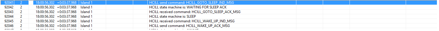

We used TI Wireless Log tool captured HCI event from TX_DBG pin of CC2564,
The log shows that just before the time out of connection,
there are many HCILL_GOTO_SLEEP_IND messages.
(not sure is it from controller to host or host to controller)
It is very strange since in our code we never called any command to enter sleep mode
Not sure whether this is a coincidence or actually cause of disconnectioon.
In a 20 minute log file, HCILL_GOTO_SLEEP_IND was not found in previous 19 minute log,
only found before time out disconnection happens

    3) In addition, how about those goto sleep HCI event,
    I have capture several DX_TBD logs, and those goto sleep event always happens,
    only happens before supervision time out.

    3) If the sleep mode is enabled, then if we have no activity on the module for 100ms we inform the host that we are going in to sleep and once we get the acknowledgment from the host.  we go to sleep.
    I don't see any problem with the sleep mode, as and when you have some activity on the module it is coming out of sleep (AWAKE state).
