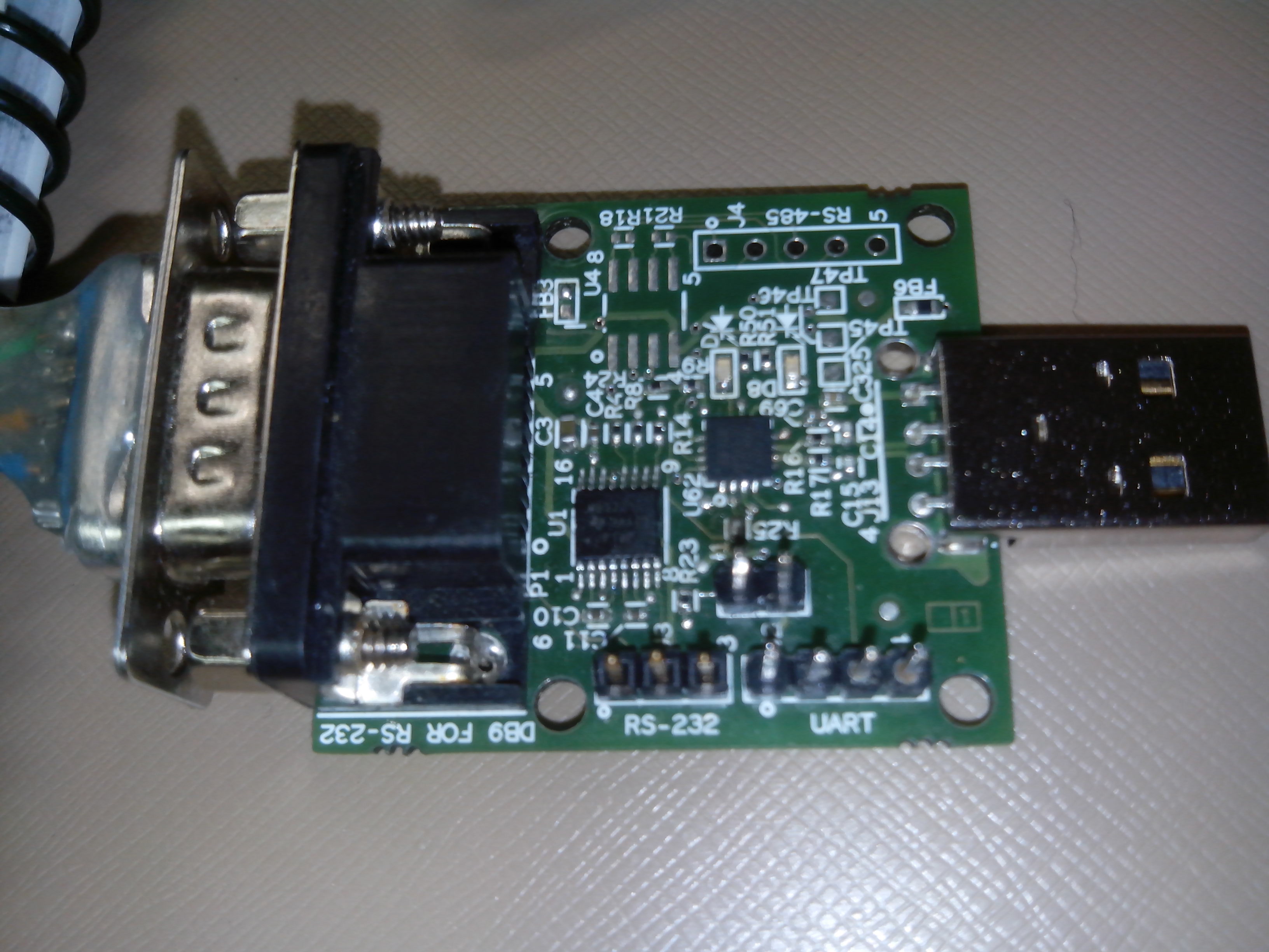

hi,
I have 2 device CC2540 and CC2541keyforb.
I want to interface sensor, which give me data on RX/TX pin of uart.
For this what project I need from the following project which is available at  location: C:\Texas Instruments\BLE-CC254x-1.4.0\Projects\ble.
I read the user guuide named as CC2540/41 System-on-Chip Solution for 2.4-GHz Bluetooth® low energy Applications and understand which configuration i need. but where I have to intialize and where I can use API's like UART_Write() or UART_Read that i can't understand.
After flashing the program i Connect hardware in following manner.
1. I draw two wire from CC2540 test pin P0.2,P03 for Rx/Tx  and connect it to Rx/Tx of USB-RS232 connector.
2. i draw two wire from CC2540 VCC and GND from CC2540 Debug pins (pin 1 and pin2) and connect it to VCC,GND of USB-RS232 connector.
then connect serial cable to PC serial port. and open hyper terminal with desired setting like COM1, desired baud rate, parity and flow control are none and 1 start and stop bit.
But after doing this when I connect  CC2540 to PC USB port of PC, I don't  get  any data(writteb on UART using HAL_UARTWrite API) on hyperterminal which I open.

Can anyone tell me where and how I have to change for UART Communication through CC2540.
please provide hardware connection detail as well if possible.
reply as soon as possible because i am stuck in this since 1.5 months.
The image of USB-rs232 converter which I use is attached here:
