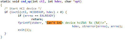

This means that the HCI interface never gets up for some reason and that the part after the deep sleep, if there is such a command in the firmware, is never run.
The way it works in the hciattach_ti.c is that to start with the communication is done over the raw com port but with HCI commands. Later, when the deep sleep has been passed a socket is created by a call to hci_open_dev, this call is returns OK.
It is the ioctl(HCIDEVUP) call that fails, which means that the setting of the send timeout is completely pointless in this case since the problem occurs before we are actually trying to send anything on the socket.
The question is why the call to ioctl(HCIDEVUP) fails with EBUSY?

Added device hci0
Can't init device hci0: Device or resource busy (16)Can't initialize device: Device or resource busy
It looks like the line discipline is not installed properly, Which is related to blueZ.

Bastian Schmitz I'm pretty curious about that You said. PAN1326 and PAN1326B are Dualmode BT and BLE modules, do You use them with kernel 3.8 and bluez-4.101, are You planning to use it's BLE capabilities?
Did you already found an answer on the device busy problem? Cause I have the same issue with the CC2564:
I use bluez on a raspberry pi 2 and all drivers are set in "make menuconfig" and the kernel is recompiled.
When I attach the device the BD address is filled in and everything seems fine but when:
$hciconfig hci0 up
$Can't init device hci0: Device or resource busy (16)
The code in hciconfig.c calls the function ioctl:
When I check with a logic state analyser, I see that when I press the command to set hci0 up: a few packets are sent and answered by the cc2564 (see all packets below). But these packets seems normal. Also under Windows the CC2564 works without problem so I don't thinks it's an hardware issue.
Any ideas what could cause this problem?
Thanks in advance!
David
