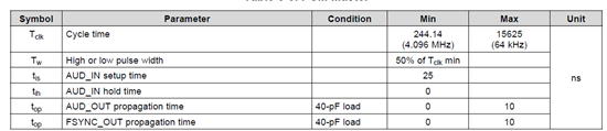

My customer is working on CC2564 module with MSP430F5438 EVM and audio DAC.
Their audio DAC master clock is made by CC2564 PCM clock,and requires over 2.8 MHz in stable.
However, CC2564 PCM clock is following FSYNC clock so that there is jitter.
Is there any idea to generate PCM clock, any pin to generate 2.8Mhz in stable?
