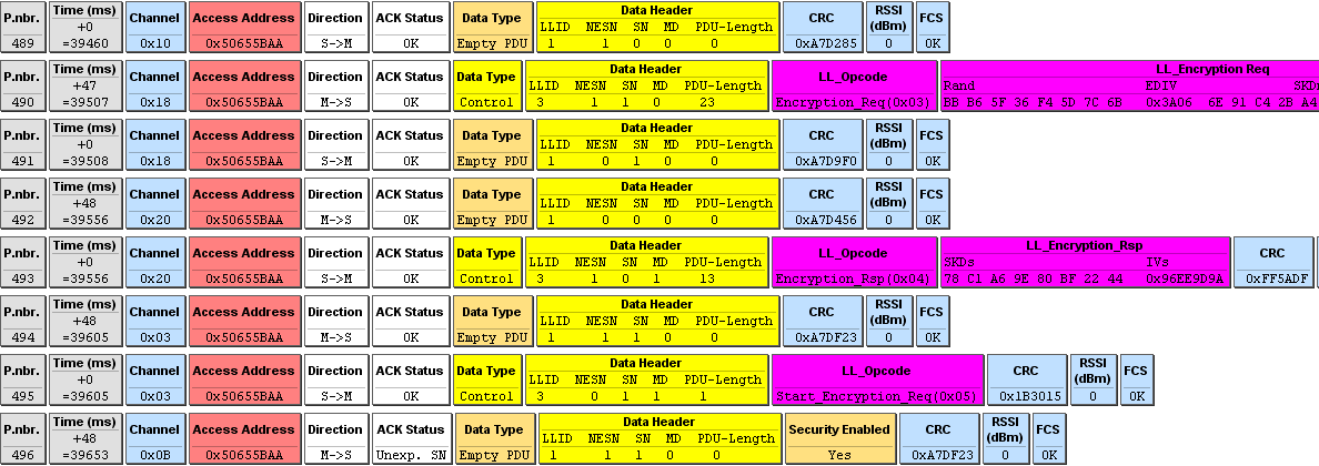

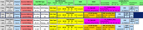

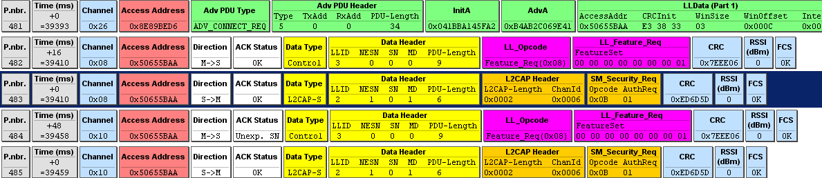

Currently doing blood glucose meters, encountered a problem, central (Android APP) will send LL_Feature_Req,
but peripheral (CC2541) does not have Response...
How can i modify firmware to response this request, just like following figure.
Below is the our customer original solution, use packet sniffer to record.
Next status will enter into an encrypted
