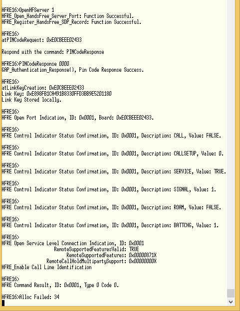

I can compile it and load it without issue, it start well and after the open stack I can see the help. According the wiki, I set the local name and open the hfp server (using OpenHFServer 1) without issue. I can see it from my mobile device and connect it.
After that I have all the expected feedback and the HFRE Command Result ok. But after two to three seconds I have the error Alloc Failed: 34 (see attach picture). If I call my cellphone connected to the Bluetooth, I can answer and hang up with the serial command, but I am wondering why I have this issue. And on the serial side I can’t make anything if I don’t call the device, and I have the LED 1 and LED 2 blinking on the MSP board.
Is anyone already seen this issue?
