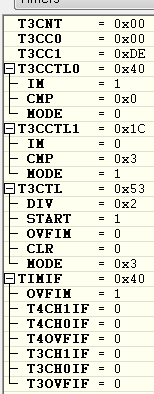

CC2540 Timer 3 Channel 1 problems
So i wrote the following function to configure channels 0 and 1 of timer 3. Problem is, when i configure channel 1, timer 3 doesn't start counting.

Here are the contents of timer 3's registers after ChannelInit has been run with parameter R, and hence channel 0 was configured. Notice how T3CNT starts counting up immediately.
Here is the same thing after running ChannelInit with parameter L. Notice how registers have the same values, except for channels 0 and 1, which are reversed. Also note how T3CNT is 0 (and stays at 0) even thought T3CTL.START is 1. For some reason the timer just isn't working. Why?

    Also, the deeper problem I see here is that when channel 1 is configured, timer 3 doesn't run at all.
  • You have set Timer 3 in mode 3, which is described as "Up-and-down, repeatedly count from 0x00 to T3CC0 and down to 0x00". Since T3CC0 is 0x00, the counter will be "counting" from 0x00 to 0x00 and down to 0x00 again, which is the same as not counting at all.
    For Timer 1, 3, and 4, channel 0 has a special meaning, as it is used as the period register in addition to having compare capabilities.
  • Right, that explains why timer didn't run when only channel 1 was configured.
    My original question was why didn't channel 1 work even when channel 0 was configured along with it.
    Answer to that question is that channel 1 and channel 0 registers aren't exactly equal - T3CCTL1.CMP and T3CCTL0.CMP are very different and have been the source of my error.
