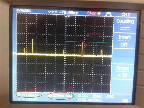

I am using cc2541- Keyfobdemo to my project.
I need to save power during advertisement.
Here i am attached image which is carrying the information of current advertisement.
1. Red circle shows current advertising power.
2. Green line shows current voltage consuming by advertising (Here i need to reduce).
3.  Again the other two circles shows 100 mV and 250 ms, Which means the ratio of current power taking.
My Requirements:
I need reduce the Power of Advertising- without changing advertising interval.

    You can also choose to advertise on one or two channels only.
    Best regards
    Joakim
  • Hi
    Thanks for your valuable reply.
    Here i am using all channels-- GAP_ADVCHAN_ALL (GAP_ADVCHAN_37 | GAP_ADVCHAN_38 | GAP_ADVCHAN_39)
    But if i am using single channels - GAP_ADVCHAN_37 or GAP_ADVCHAN_38 or GAP_ADVCHAN_39  i am able to modify the transmit power.
    Actually, i need to reduce the transmit power in all channel modes.
    In this situation what is the possibilities to reduce the advertisement transmit power?
