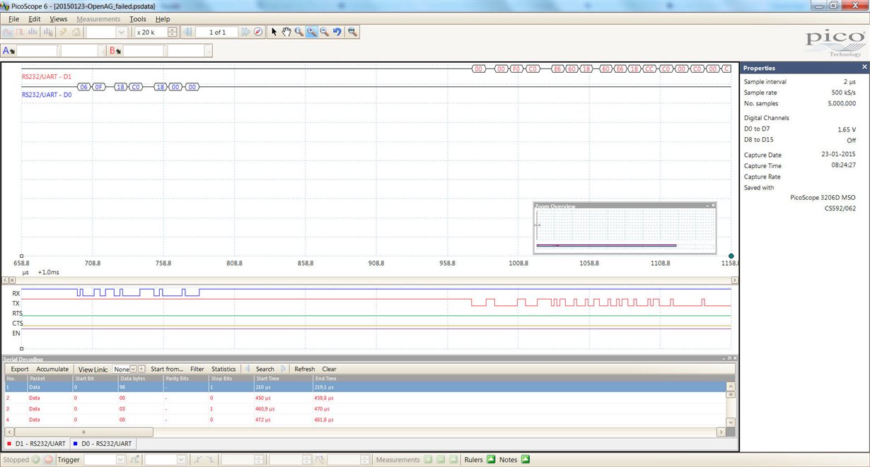

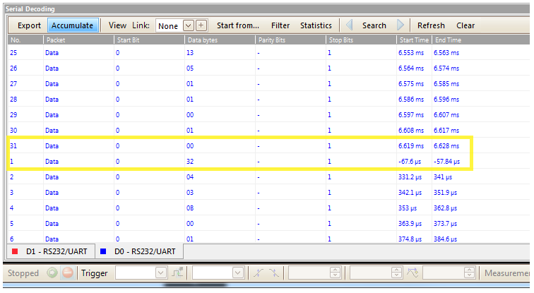

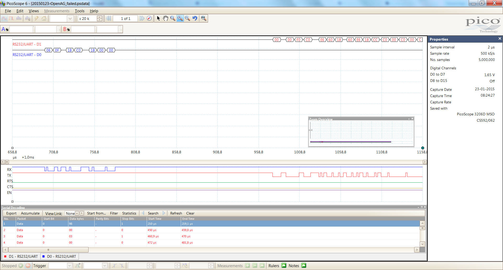

  • Hi Samuel,
    I think the best option would be for you to install the software that comes with my logic analyzer:
    https://www.picotech.com/download/software/sr/PicoScope6_r6_10_11.exe
    I've attached 4 captures with the UART decoded (with and without the PWM timer and RX or TX as trigger). You need to rename them to .psdata.

  • Thomas,
    I installed the software but I'm having a hard time getting the data in the format I need and also interpreting the data. Maybe you can help.
    1. What is the purpose of the what the app calls buffers? The buffers are fragmenting the data and I need to see the data continuously. Can the 10 buffers in 20150122_OpenAG_ok_without_timer_TX_trigger.txt be combined into 1?
    2. In the serial decode window at the bottom there is an "Accumulate" button and I think it combines the buffers like I need, can you confirm?
    3. In the serial decode window there is a "Start Time" field but the numbers are not always incrementing. I thought that this was because the data bytes appeared in a separate buffer, and with each buffer the count was starting over, but I see that it is grouping the bytes into packets and this is the reason for the numbers jumping up and down. The bytes it groups into packets though aren't sent back to back, why is it grouping the bytes into packets like this?
    4. Related to 3 but more importantly, I need the absolute time a byte is sent. I looked through all of the program's options and I don't see any way to do this. Do you know of any way?
    5. I need to analyze the RX and TX lines together, and I need the absolute time of each byte sent. How can I do this?
    I recommend trying a Saleae logic analyzer. I can't speak for the quality of the logic analyzer, it may be good or bad, I don't know, but the software is very simple and practical to use. There is virtually a zero learning curve with their software. Plus they are relatively inexpensive.
    I don't see any transitions on RTS, CTS, or BT_EN at all. I don't think these lines are related to the problem.
    Samuel
  • Hi Samuel.
    1. The analyzer captures 10 division and transfers them to the pc. So 1 ms/div will give 10 ms per buffer. It's not possible to combine them.
    2. The accumulate button just keeps the data in the "serial decoding" window between each new capture. The start time is however still reset so not very useful.
    3. The start time increment for me. However the unit changes from picosecs. -> microsecs. -> millisecs. Yes the start time resets on every new buffer. I don't see any grouping. Can you send a screen dump? I've included one.
    4. No. It's reset on every new capture.
    5. I tried with both TX and RX as capture trigger to make sure we didn't miss any data, but they both look the same to me, so you should be able to use either of them. Why is the absolute time important? Wouldn't response time from the headset be irregular.
    Is not so much the price as the delivery time for Saleae logic analyzer. We need to figure this out ASAP.
    I'll try tomorrow if I can set the time/div sufficient high to get all the data in one buffer and still have the number of samples high enough for it to be useful. I will have it ready for you when you get into the office, and I will be online again around 1 PM Dallas time (8 PM my time) to answer any questions.
    /Thomas
  • Thomas,
    3. Here's a screenshot with the one example of the problem highlighted:
    5. There's some miscommunication going on here. By absolute time I don't mean the wall clock time, I simply mean the time of an event, so that I can determine the time difference between rx and tx events.
    Samuel
  • Hi Samuel,
    3. I think it's because you press the accumulate button. It just gather the decoding into one but the start time is still reset between each buffer.
    5. No. I knew what you meant. :)
    I've managed to capture the full communication in one buffer and I've export the serial decoding to a spreadsheet for you. Let me know if you have any questions. I'll try to be online from 1 PM to 3 PM Dallas time.
    /Thomas

  • Thomas,
    I still see the same issue here that I showed you in the screenshot with the time periodically going backwards, see lines 91 and 92 in the spreadsheet:
    89 Data 0 FE - 1 3,975ms 3,984ms
    1  Data 0 04 - 1 355µs   364,8µs
    I also need to see rx on the same time axis as tx.
