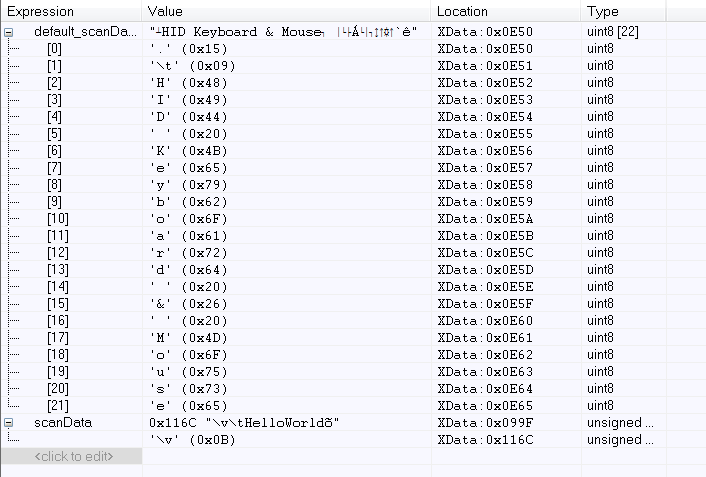

  • Hi Arun,
    I made a mistake with the pointers in the createScanResponseData function and during setting the scanData scan response. So block 2 and 3 has been changed to as follows:
    2. During initialization, device checks for stored value and use the stored value if it's legit.
    if(*device_name_crc != getCRC(device_name, *device_name_length)) {
          printf("Using default scan response name\r\n");
          GAPRole_SetParameter( GAPROLE_SCAN_RSP_DATA, sizeof ( default_scanData ), default_scanData );
        } else {
    //      printf("Using stored scan response name\r\n");
          printf("%s\r\n", device_name);
          scanData = createScanResponseData(device_name, device_name_length, scanData);
    //      printf("Scan response address: %x\r\n", scanData);
          printf("created scanData structure:\r\n");
          printf("Length: %i\r\n", scanData[0]);
          printf("GAP_ADTYPE_LOCAL_NAME_COMPLETE set: %i\r\n", scanData[1] == GAP_ADTYPE_LOCAL_NAME_COMPLETE);
          uint8 i;
          for(i = 2; i  < scanData[0]; i++) {
            printf("%c\r\n",scanData[i]);
          uint8 status = GAPRole_SetParameter( GAPROLE_SCAN_RSP_DATA, sizeof ( scanData ), scanData );
          //uint8 status = GAPRole_SetParameter( GAPROLE_SCAN_RSP_DATA, sizeof ( default_scanData ), default_scanData );
          //printf("%i\r\n", status);

    The serial capture prints as follows:
    HelloWorld
    Length: 11
    GAP_ADTYPE_LOCAL_NAME_COMPLETE set: 1
    H
    e
    l
    l
    o
    W
    o
    r
    l
    On my tablet, the scan response name is now gibberish (a bunch of question marks and stars) but this is great, at least the scanData is being changed. Can you help me with figuring out why even though the scanData structure seems correct but the device does not register it correctly?
    Cong
  • I think the problem lies in line 18 of block 2:
    Everytime the device restarts, the complete (scan response) name extracted from the scan records changes so whatever is being set is not constant. I'm out of my depth here so I would really appreciate a reply.
    Cheers,
    Cong
  • I figured a walkaround by directly modifying the default_scanData variable. It's all good now.
    Yes. You can set the new scanRspData by using the command
       GAPRole_SetParameter( GAPROLE_SCAN_RSP_DATA, sizeof ( scanRspData ), scanRspData );
    But do note that in most applications scanRspData is declared as static and hence any changes you make may not get reflected. Please remove the static qualifier while declaring the scanRspData variable array.
    Arun
