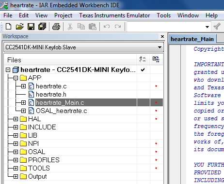

On page 22 of the TIDA-00096 reference design manual,
The problem is, under APP tab, I could not find the TI_cc254x_spi in the BLE stack v1.4.0, see below,
I downloaded and applied CC254x SPI driver patch v1.4.zip file from processors.wiki.ti.com/index.php/CC254x_SPI_Driver_User_Guide, but still the same!
So where can I find the source code to change the configuration settings for the ADS1293 device?  Thanks!

  • The BLE+ADS1293 software stack source code is undergoing a licensing update and should be back online when the process is completed.
    Thanks for your patience.
    Sergio
  • Hello Lei Chen,
    The firmware stack software for the TIDA-0096 reference design if back online. Please go to the tool page (http://www.ti.com/tool/TIDA-00096) and scroll-down to the software section. You may be asked to fill out a form before your can download the firmware source code.
    After download, extract and run the setup.exe file. This will install the source files in your computer. I found the TI_CC254x_spi.c file in the following folder:
    C:\Program Files (x86)\Texas Instruments\ADS1293_BLE\BLE-CC254x-1.3\Projects\ble\HeartRate\Source\TI_CC254x_spi.c
