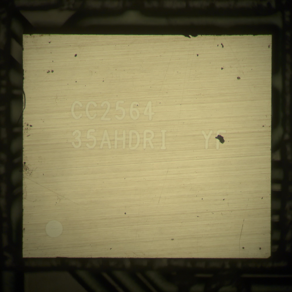

There is an error while running SPPLE Demo code on the MSP430F5229 MCU with CC2564YFV-based circuit (see [CC2564YFV_Debug2_RF_config.pdf])
The function BSC_Initialize returns error -4 instead of 0 in
static int OpenStack(HCI_DriverInformation_t *HCI_DriverInformation, BTPS_Initialization_t *BTPS_Initialization)
Result = BSC_Initialize(HCI_DriverInformation, 0);
The Altium Designer project with Gerber production files attached [CC2564YFV_Debug2.zip].
There is no error (Result == 0) while running the code on MSP430F5229+CC2564BRVM (QFN package) circuit with similar schematic.

    The TI Bluetooth stack is already ported to MSP430F5229 MCU. There is no error (Result == 0) while running the code on MSP430F5229+CC2564BRVM (QFN-packaged) circuit with similar schematic. The problem appears only with CC2564YFV (DSBGA-packaged) IC.
    Ok. QFN is working and CC2564YFV is not working, But the error looks like the UART is not configured correctly,
    can you check if CC2564YFV is CC256x or CC256xB?
    QFN is CC256xB, I am not sure if CC2564YFV is CC256xB or CC256xA, Could you please read the local version information, to check the LMP subversion.
    LMP subversion for CC256xB is 0x1B90(instead of 0x1B0F for CC256xA).

    CC2564 QFN = CC2564B on the CC256xQFNEM and on the our prototype's board.
    CC2564 YFV = CC2564 (without letter B, see photo) on the our debugging board.
    There is no more initializing error with MSP430F5438+CC2564YFV (see http://youtu.be/7AN4aO-ciII). It was fixed by removing the #define __SUPPORT_CC256XB_PATCH__ line from our firmware source code.
