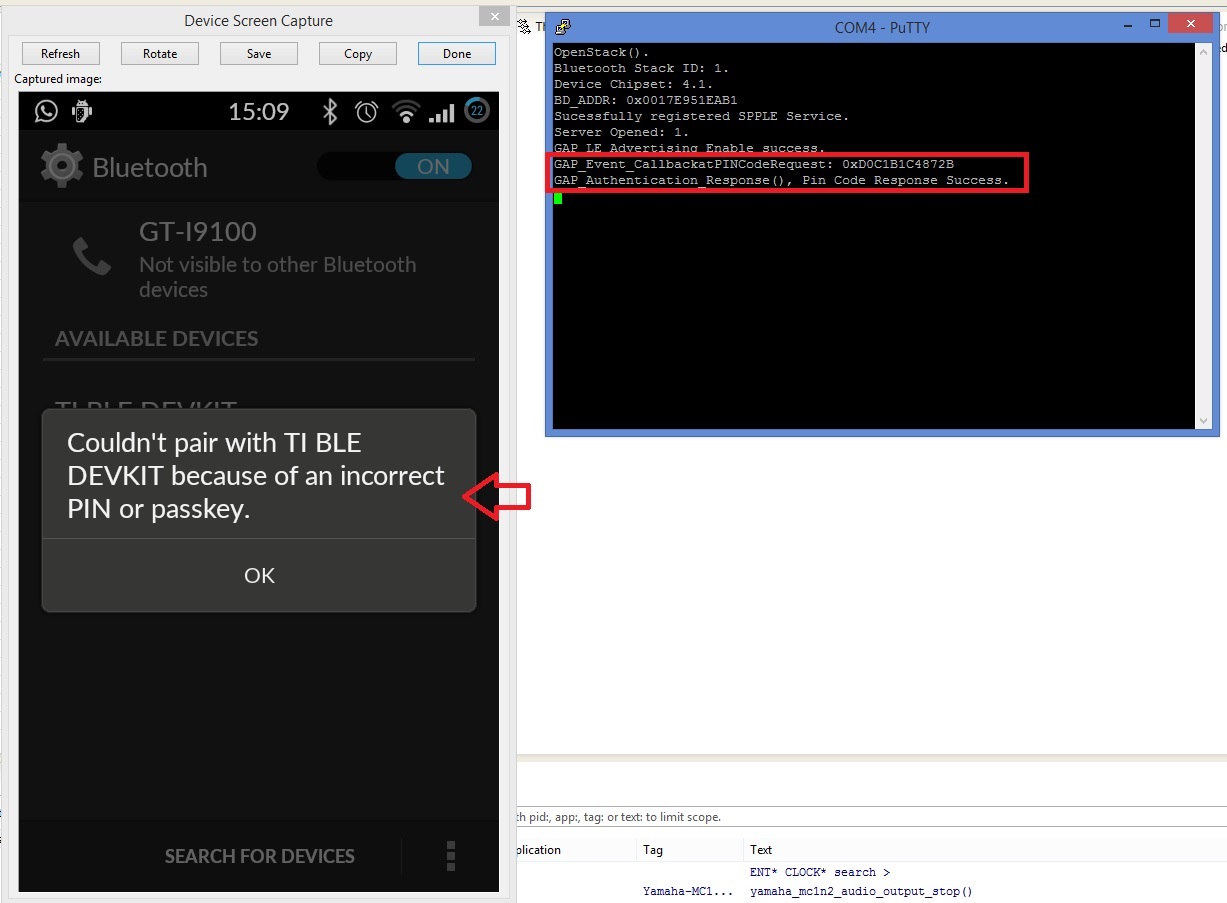

I'm using Bluetopia Release v1.5 R2 (4.0.1.10) SDK and SSPLEDemo as a template to develop my code and I'm facing a strange behavior with PIN validation flow.
At PINCodeResponse(&Params) function a verification like below is being done:
 ASSIGN_PIN_CODE(PINCode, 0, 0, 0, 0, 0, 0, 0, 0, 0, 0, 0, 0, 0, 0, 0, 0);
 BTPS_MemCopy(&PINCode, TempParam->Params[0].strParam, BTPS_StringLength(TempParam->Params[0].strParam));
 /* Populate the response structure.                         */
 GAP_Authentication_Information.GAP_Authentication_Type      = atPINCode;
 GAP_Authentication_Information.Authentication_Data_Length   = (Byte_t)(BTPS_StringLength(TempParam->Params[0].strParam));
 GAP_Authentication_Information.Authentication_Data.PIN_Code = PINCode;
 /* Submit the Authentication Response.                      */
 Result = GAP_Authentication_Response(BluetoothStackID, CurrentCBRemoteBD_ADDR, &GAP_Authentication_Information);
The problem is that even when I entered a wrong PIN GAP_Authentication_Response is returning 0.
Link is not created and device not paired when PIN is wrong but the strange think is GAP_Authentication_Response returning 0 all the time.
How can I solved this issue?
