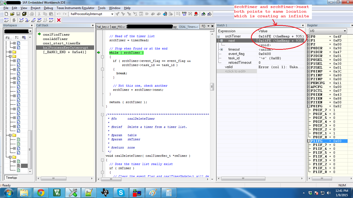

I am using CC2541 with TI BLE stack version 1.3.2. In some cases after being connected to iPhone(not sure whether this is connection specific or random, but I am observing with iPhone) my device goes into infinite loop in function. It loops forever in while loop.

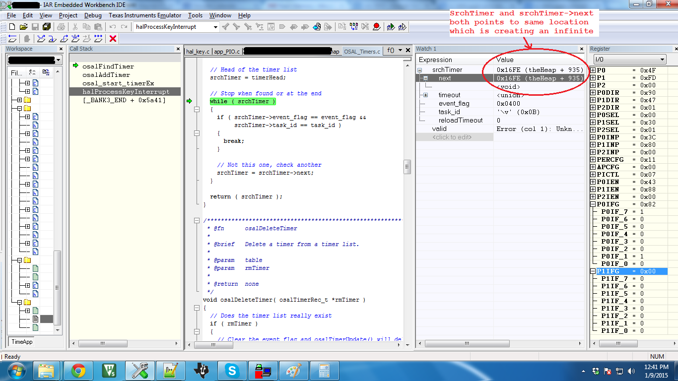

I have also attached a snapshot which says that srchTimer and srchTimer->next both points to same location and which is causing an infinite loop. Have anyone encountered the same issue anytime, if yes then what is the root cause of this?

  • Check if you keep using osal_start_timerEx to create too many timer? By the way, this is  ZigBee®, 6LoWPAN & 802.15.4 MAC Forum and I suggest you post your question at Bluetooth® Low Energy Forum.

    My concern is that even I am allocating too many timers then at some instant TI framework should stop allocating events rather than creating an infinite loop. Have you ever faced any situation like this?
    Maulik
  • BLE-Stack won't stop timer event for you. You have to use osal_stop_timerEx to stop timer by yourself.
  • I understand your concern but when I say "even I am allocating too many timers then at some instant TI framework should stop allocating events rather than creating an infinite loop", what I mean is, say for example TI is able to allocate 100 timers(may not be the real figure, I am just taking for example) and I already allocated 100 timers by calling osal_start_timerEx, but I still need one more timer(101th) then I will again call osal_start_timerEx function and if TI is not having enough memory then it should not allocate this timer and should return with error, currently I am not checking for error codes received from this function but my concerns is anyways TI should not create an infinite loop, I am OK if it does not start a timer and return with error code, But I am not OK if it is causing an infinite loop which we can clearly see in image I uploaded above.
