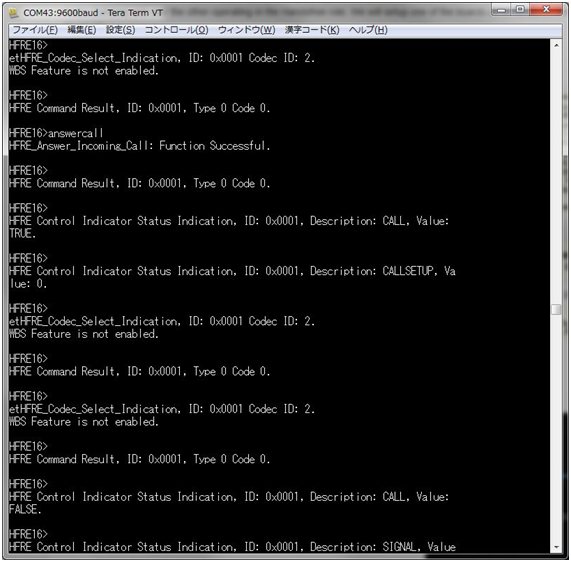

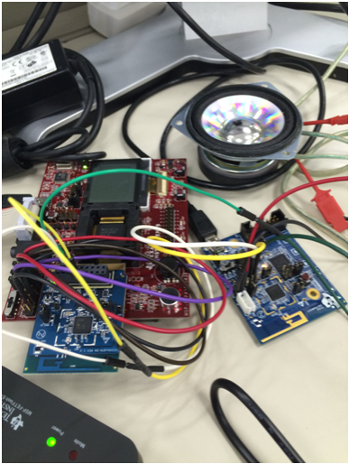

    Meanwhile we tried to do some testings with MSP-EXP430F5438+ CC256XQFNEM + BT-MSP-AUDSINK + PassiveSpeaker
    and a iPhone5S as shown below. (Running HFPDemo on MSP430F5438A)
    But we didn't get any audio output on the PassiveSpeaker..
    We get an error on the PC Terminal saying "WBS Feature is not enabled" as shown below.
    Could you please let us know what could be this error and if there is any workaround.
    Best Regards
    Kummi
  • Hello Kummi,
      You may be running into some of the same APPLE related issues we are having with the BT Stack.  It does not seem possible to initiate a HF connection from the CC2564 with TIVA BT stack.  Regardless of the Port specified, the connection either closes after a short time, or fails to open completely.  So always try to connect by using the phone itself and clicking on the device to pair and connect in the Bluetooth screen.
       Apple devices also have a problem negotiating the Software Codec (CVSD or mSBC with WBS support.  I recommend removing the HFRE_HF_CODEC_NEGOTIATION_SUPPORTED_BIT bit from the HFRE_SUPPORTED_FEATURES #define.  Then you can force whatever software codec you want to use.
       It is NOT necessary to have a hardware codec connected to the I2S/PCM bus for the software side of things to function.  You'll obviously have no audio flowing, but the IO pins will wiggle just fine.
        We have had no problems opening the remote audio gateway on android devices and then opening an SCO connection.  This is with or without WBS enabled.
        On Apple phones it also works fine, provided the phone initiates the pair, HF connection and opening of the SCO connection.  This is unacceptable - the CC2564 must have a way to reconnect if powered down or if it goes out of range... but we've not found a work around to date.
        Hope that helps at least share our experience.  Please try disabling codec negotiation and seeing if things improve.
     - Jason
  • Hi Jason,
    Thank you so much for the helpful information.
    And I am sorry for the delay.
    As per your suggestion ManageAudio seems to the working
    by commenting out "HFRE_HF_CODEC_NEGOTIATION_SUPPORTED_BIT".
    We are yet to get the audio output but there was some signal
    output from the I2S between CC256XQFNEM <->TAS2505.
    Currently we are able to run the ManageAudio
    but we are not getting the below kind of LOG on the PC Terminal.
    "etHFRE_Codec_Select_Indication, ID: 0x0001 Codec ID: 2."
    Do we need to modify the HFPDemo APP source regarding the
    I2S settings(CC256XQFNEM <->TAS2505)?. In that case it would be helpful
    if there is any suggestions on which part of HFPDemo.c should be modified.
    Best Regards
    Kummi
  • Hello Kummi,
       Here is a log of my pairing with an BlueGiga device, opening a Remote audio gateway connection it, then opening an SCO audio connection to it.
    https://drive.google.com/file/d/0B9EYwAWdSUu2RkFXaUdYM0xMYWM/view?usp=sharing
       This is a log of an Apple phone seeing the CC2564, and the phone initiating a pair, HF connection and then opening an SCO connection when a phone call is made.  Then we close/open it a few times before hanging up and disconnecting the HF connection.
    https://drive.google.com/file/d/0B9EYwAWdSUu2YVFQRjJ1cjVBVFE/view?usp=sharing
       We have not found any way for the CC2564 to open a remote audio gateway with an Apple phone.  So you must always initiate the connection from the phone.  This obviously won't work for most products, but we're hoping TI can get us some support on it here soon....
        Attaching a CODEC to the CC2564 can be tricky.  Not all CODECs are compatible, and many must be properly configured through their SPI or I2C interface to present the proper I2S/PCM data.   The CC2564 must also have its I2S/PCM bus configured for the proper bitrate and frequency the CODEC is expecting.
      Looking at that CODEC, you must be sure to configure it for DSP mode.  That is the mode where WCLK is being used as FSYNC.
      I hope this helps some.  Just takes time to get it all configured correctly.  And it would be really nice if TI could investigate the CODEC negotiation problem.  Apple support disclosed this was a problem with the Bluetopia Stack, but without paying money I couldn't learn exactly where the problem lies - and even if I did know, without the source I cannot fix it.
       Finally, please let me know how working with the Apple phones go.   We'd be really interested to know if you are ever able to have the CC2564 re-establish a HF and SCO connection after walking out of range, or after power-cycling without initiating it from the phone itself.
    -  Jason
