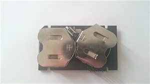

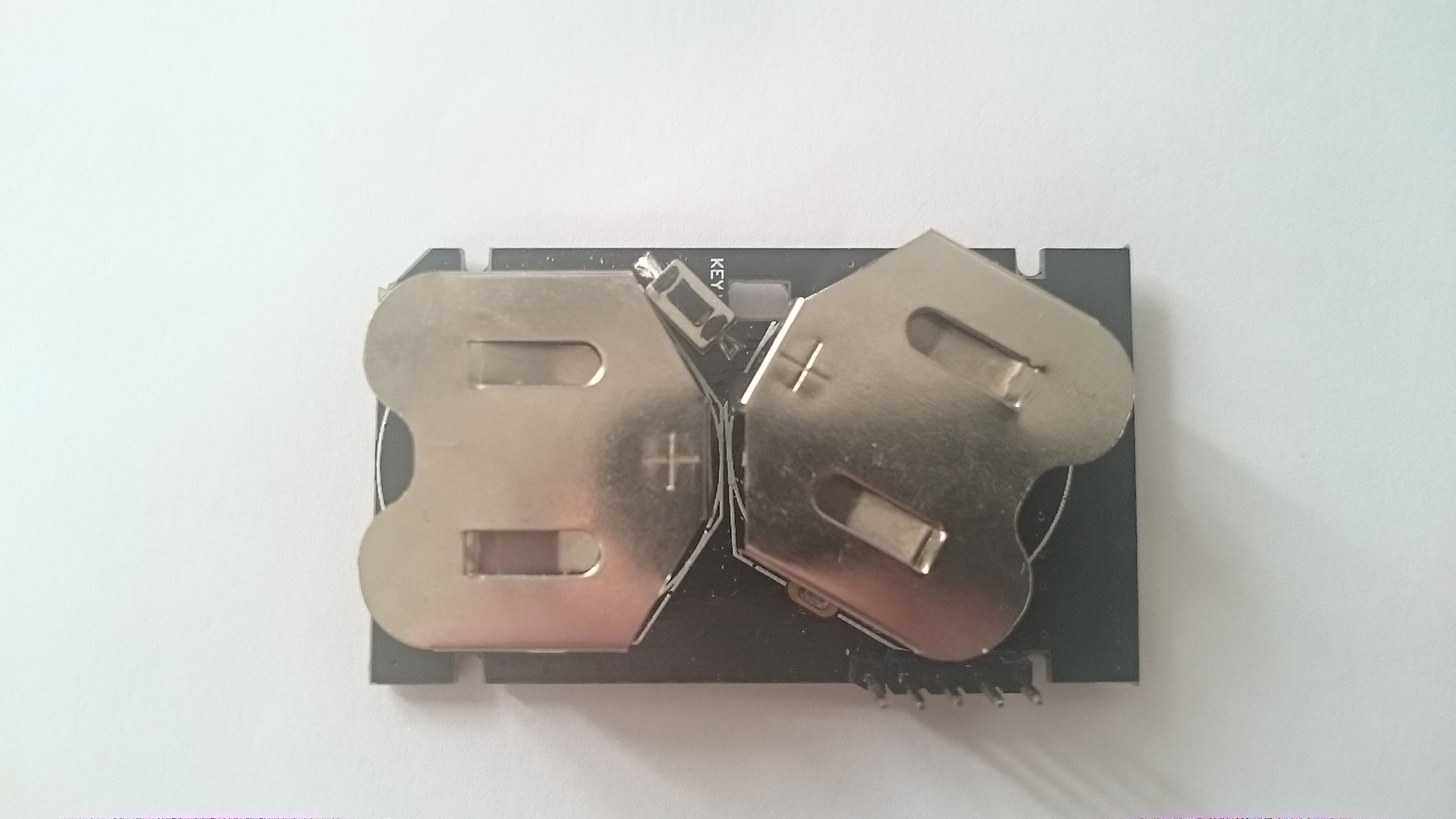

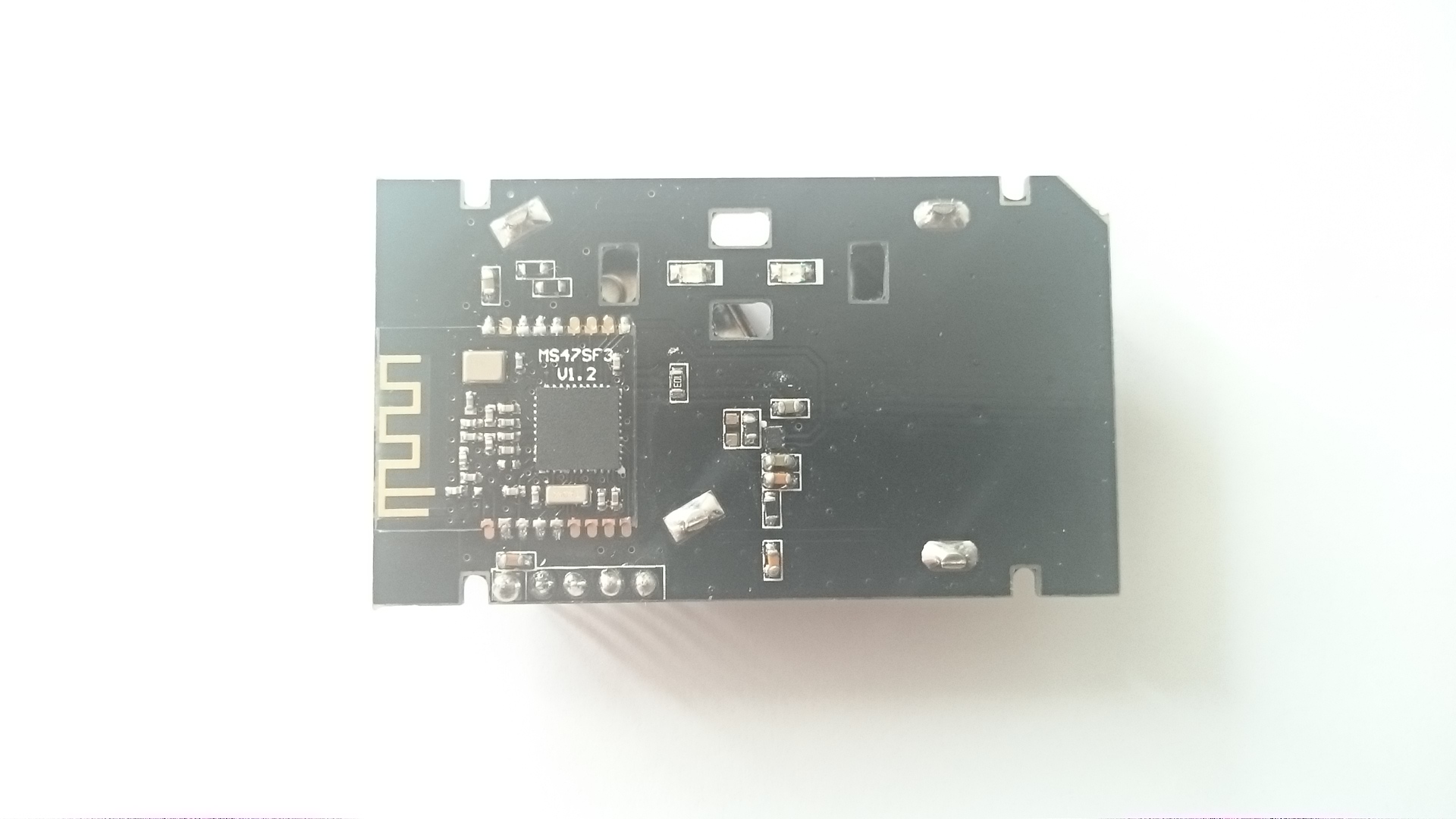

hi guys, i'm trying to program a Beacon based on CC2541 soc and BLE stack1.4.
I have Minew Beacon with two Led and one KEY.

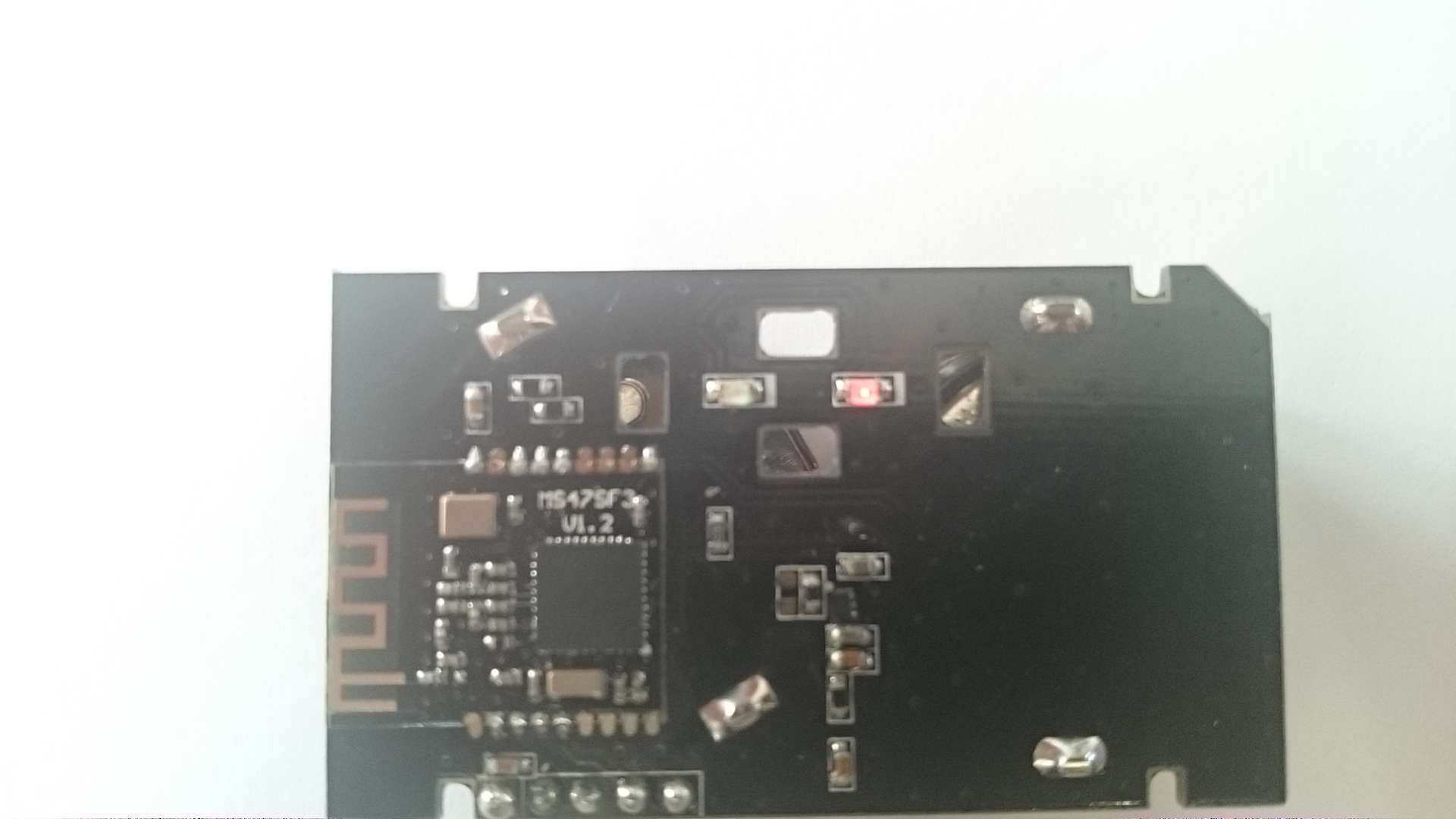

Now to understand the basic concepts, i would turn on or turn off the two led installed on my board when i tun on or turn off my boad used key.
After i'm flashing the firmware simpleBLEPeripheral i can see the red light fixed on, and it's don't change even if edit the code below
HalLedSet( (HAL_LED_1 | HAL_LED_2), HAL_LED_MODE_OFF );
there is a method or service that returns the state or the presence of KEY or LED or other peripheral and at which port, of cc2541, their are connected?

  • ok i've change the value of register because the led are connected to pin p0.1 and p0.2.
    thanks dhaval.
    Now i think that the key is connected on pin p0.3 and i wolud turn on or turn off the board by pressing the button.
    can suggest me.
    you could show me how to try to achieve this.
    I've find the register HAL_KEY and PWRMGR but i don't undestand how manage the procedure (callback, preiodic scan event, interrupts.
