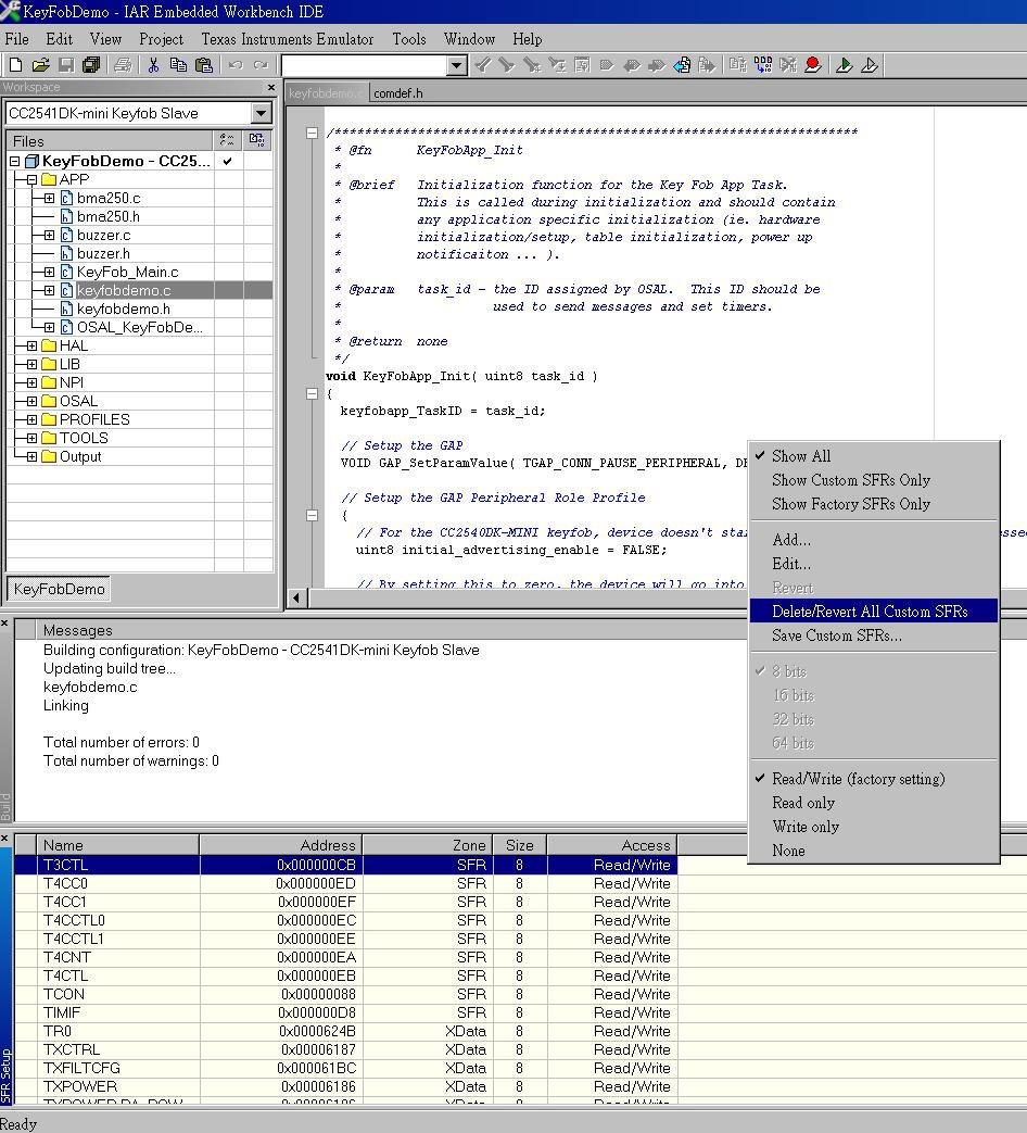

SFR debug warnings for sensorTag
I get these debug warnings.  Any way to turn these off? Not sure what I changed other than removing some of the sensorTag functionality - like getting rid of gyro, etc.
Mon Feb 23, 2015 16:10:45: The custom SFR file 'C:\Texas Instruments\BLE-CC254x-1.4.0\Projects\ble\SensorTag Status\CC2541DB\SensorTagCustomSfr.sfr' contains a modification of the factory
SFR 'MEMCTR'. This SFR cannot be found in the used factory SFR file 'C:\Program Files (x86)\IAR Systems\Embedded Workbench 6.4\8051\config\devices\Texas Instruments\ioCC2541F256.ddf'
