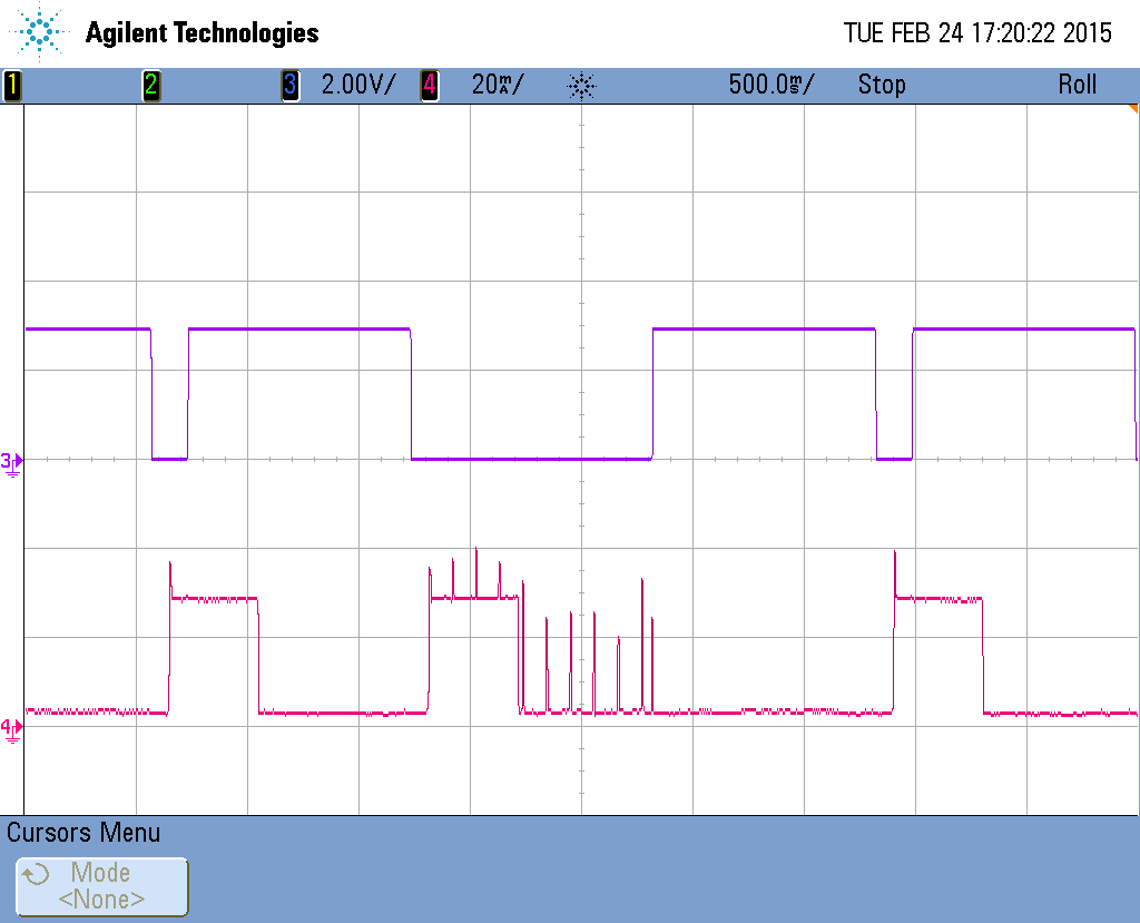

I'm using a CC2541 as SPI Network Processor (HostTestApp) in connectable peripheral mode with Power Savings and the GATT DB off chip.  I notice that when ever I send the GAP Make Discoverable command that the CC appears to stay in active mode for 400ms even if I send the End Discoverable and get the responses before that time expired.  Advertising, however seems to stop immediately with the End Discoverable.
I assume this is just a delay to prevent running off the sleep timer until the 32Khz crystal is started.  I am assuming this as I noticed there is an extension command to tweak this time.
  1. Is this assumption correct?
  2. Why isn't the crystal shut down and delay canceled immediately after the End Discoverable?
In the scope trace below, violet is low at the initiation of the Make Discoverable and high at the End Discoverable.  Red is a 3X current probe.

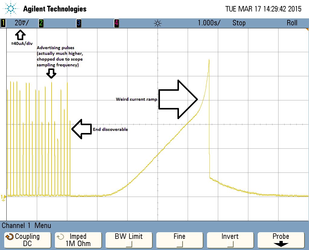

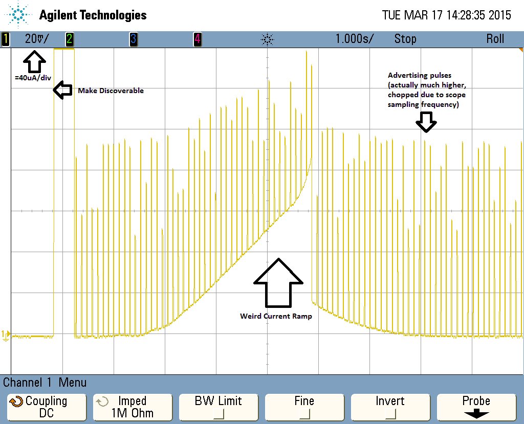

  • It gets worse.  I added a work around to delay for the cases of 400ms of excess current after the start and end discoverable but am still having issues with the CC2541 consuming current where it probably shouldn't need to.  I isolated the CC2541 traces on my board and added a high resolution current probe between the supply and the CC2541.  When I zoom in on the current axis at the start and end discoverable events, I also see a weird ramp for almost 5 seconds that eventually hits more than 0.2mA peak before returning to normal.  Can this be explained?  I can work around a 400ms delay, but a 5 second delay would kill the user experience of our application.

  • Nathan,
    The current ramp looks to me like something that can happen due to a floating input pin without pull enabled.
    .:Svend
  • Makes sense. I set the GPIO without pull as outputs, the SPI inputs should be held by the other micro, and I leave the others as is (which looks like it turns the pull on). Is the SPI output MISO taken out of output/peripheral mode with power savings or something? I will try pulling it.
  • The IO's should all retain their mode and/or output value in all power modes.
  • If that is the case, aren't all of the GPIO but the SPI left to the default (input w/ pull-up) with the HostRelease? As I mentioned I took care of the 20mA pins which don't have pullups by initializing them as outputs. We aren't using any other GPIO pins besides the SPI, SRDY (SPI interrupt), and the other obvious ones (crystals, power, bias, antenna).
  • OK. The weird current ramp problem is solved. It was indeed the MISO pin floating. This is most likely coming from the multiple-slave capability of the SPI peripheral is unrelated to the power mode. I was incorrectly assuming it would remain an output. This obviously would break the capability of having multiple slaves. I will assume this is my own problem. Thanks for pointing to the IO pin and the solution.
