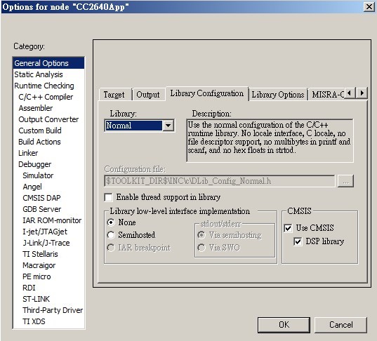

  • Hi All,
    Currently we are used IAR to enable the CMSIS-DSP library, see the picture attached, the problem is that the flash size will increase a lot when enable, above flash and ram size were the result when enable it.
    We only need the 1024 or 512 FFT + square function, so anyway to reduce the library size or function used for replace the CMSIS-DSP.
    Gary Lin
  • About IAR CMSIS LIB
    C:\Program Files (x86)\IAR Systems\Embedded Workbench 7.2\arm\CMSIS\index.htm
    IAR 7.20.1 => CMSS 4.0
    IAR 7.40.1 => CMSIS 4.1
