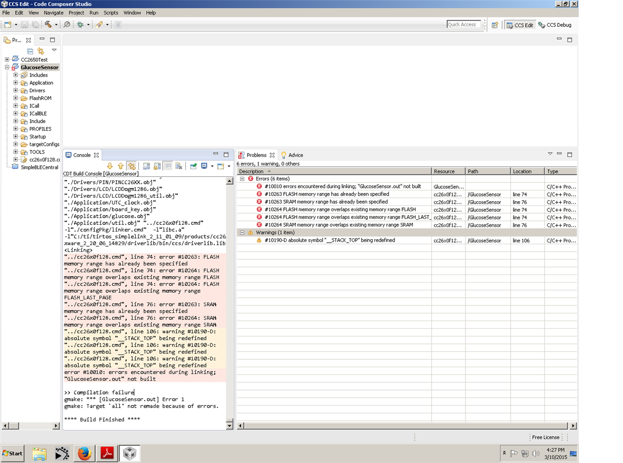

Now I'm having trouble building the GlucoseSensor example and several other examples.  I get errors (see attached print screen).  According to the software developer's guide, "Except for the SimpleLink Bluetooth Smart CC2650 SensorTag, most sample applications described in this section are intended to run on the SmartRF06 Evaluation Board using a CC26xx Evaluation Module."  I selected in the project properties to use the CC2650F128, which is the chip on the board I have attached to the SmartRF06.

    For the BLE-Stack v2.0, CC2650 & CC2640 can be considered the same. CCS is very sensitive to changes in the chip family setting due to functional dependencies. Please delete the project from your workspace, re-import, and rebuild with the default settings.
