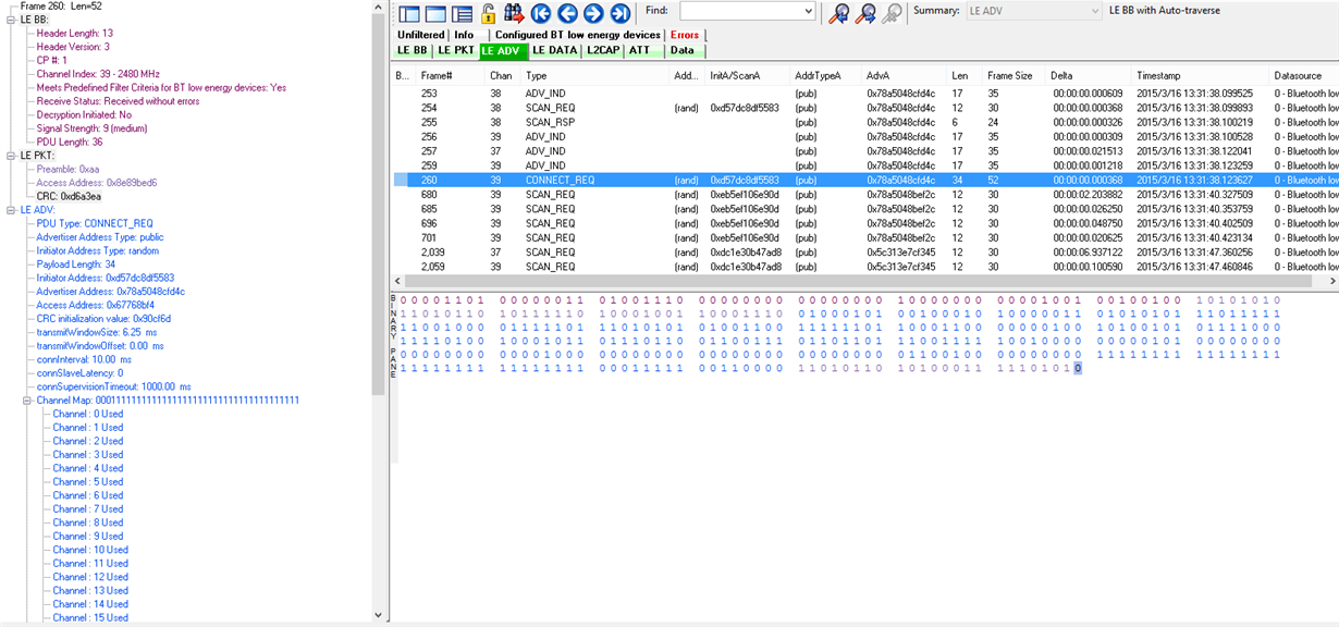

I'm doing a test between CC2541 and Nordic NRF51822. The CC2541 work as a peripheral role. NRF51822 as central role.
I want update the connection interval after CC2541 establish a connection to NRF51822. The bellow is my test parameter.
GAPRole_SendUpdateParam(6, 20, 0, 400, 0).
This can works when CC2541 connect to CC2541 central device.
And I use the BPA sniffer to capture the packets between the TI and Nordic. I didn't see any packet LL_CONNECTION_UPDATE_REQ on the air.
So what happened in the TI peripheral stack when connect to Nordic?
