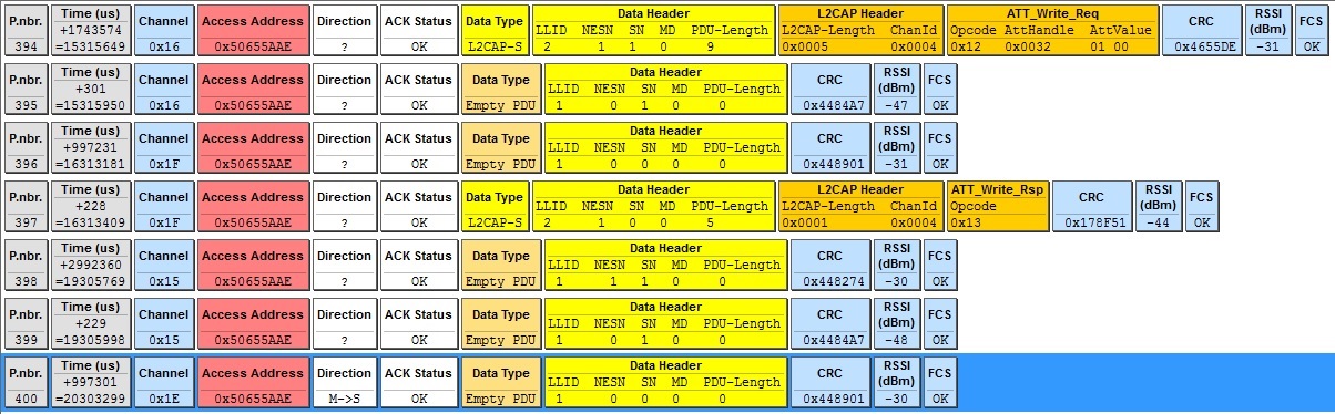

I am working on CC2650 while two weeks. Currently, I'm trying to add characteristic 6 that almost the same with characteristic 4 into SimpleBLEPeriperal project, but it can not notify anymore.
Bellow is the package sniffer info. That can see the client already written a value with "0x0001" to handle 0x0032 to trigger NOTIFY event, but not work.
Of course, I add sub-routine in "SimpleBLEPeripheral_performPeriodicTask()", likes below:
static uint8_t count = 0;
SimpleProfile_SetParameter(SIMPLEPROFILE_CHAR6, sizeof(uint8_t), &count);
count++;
If there are some missing to do?

    I found the reason why the Characteristic 6 does not notify, show as below:

    But, here is the callback for att read. Why the client write 0x0001 to handle 0x002B to enable notification will run into this callback?

    You probably get that callback because the master reads out the current value of the attribute before changing it (doing a write).

          0,
          &simpleProfileChar3Props
          // Characteristic Value 3
            { ATT_BT_UUID_SIZE, simpleProfilechar3UUID },
    		GATT_PERMIT_READ,
            0,
            &simpleProfileChar3
    	  // Characteristic 3 configuration
    	          { ATT_BT_UUID_SIZE, clientCharCfgUUID },
    	          GATT_PERMIT_READ | GATT_PERMIT_WRITE,
    	          0,
    	          (uint8 *)&simpleProfileChar3Config
          // Characteristic 3 User Description
            { ATT_BT_UUID_SIZE, charUserDescUUID },
            GATT_PERMIT_READ,
            0,
            simpleProfileChar3UserDesp
        // Characteristic 4 Declaration
          { ATT_BT_UUID_SIZE, characterUUID },
          GATT_PERMIT_READ,
          0,
          &simpleProfileChar4Props
          // Characteristic Value 4
            { ATT_BT_UUID_SIZE, simpleProfilechar4UUID },
    		GATT_PERMIT_READ,
            0,
            &simpleProfileChar4
          // Characteristic 4 configuration
            0,
            (uint8 *)&simpleProfileChar4Config
          // Characteristic 4 User Description
            GATT_PERMIT_READ,
            0,
            simpleProfileChar4UserDesp
        // Characteristic 5 Declaration
          GATT_PERMIT_READ,
          0,
          &simpleProfileChar5Props
          // Characteristic Value 5
            { ATT_BT_UUID_SIZE, simpleProfilechar5UUID },
    		GATT_PERMIT_READ,
            0,
            &simpleProfileChar5
    	  // Characteristic 5 configuration
    	          0,
    	          (uint8 *)&simpleProfileChar5Config
          // Characteristic 5 User Description
            GATT_PERMIT_READ,
            0,
            simpleProfileChar5UserDesp

       simpleProfileChar1Config = (gattCharCfg_t *)ICall_malloc( sizeof(gattCharCfg_t) *linkDBNumConns );
       if ( simpleProfileChar1Config == NULL )
         return ( bleMemAllocError );
       // Initialize Client Characteristic Configuration attributes
       GATTServApp_InitCharCfg( INVALID_CONNHANDLE, simpleProfileChar1Config );
       // Allocate Client Characteristic Configuration table
        simpleProfileChar2Config = (gattCharCfg_t *)ICall_malloc( sizeof(gattCharCfg_t) *linkDBNumConns );
        if ( simpleProfileChar2Config == NULL )
        GATTServApp_InitCharCfg( INVALID_CONNHANDLE, simpleProfileChar2Config );
         simpleProfileChar3Config = (gattCharCfg_t *)ICall_malloc( sizeof(gattCharCfg_t) *linkDBNumConns );
         if ( simpleProfileChar3Config == NULL )
         GATTServApp_InitCharCfg( INVALID_CONNHANDLE, simpleProfileChar3Config );
      simpleProfileChar4Config = (gattCharCfg_t *)ICall_malloc( sizeof(gattCharCfg_t) *linkDBNumConns );
      if ( simpleProfileChar4Config == NULL )
      GATTServApp_InitCharCfg( INVALID_CONNHANDLE, simpleProfileChar4Config );
      simpleProfileChar5Config = (gattCharCfg_t *)ICall_malloc( sizeof(gattCharCfg_t) *linkDBNumConns );
      if ( simpleProfileChar5Config == NULL )
      GATTServApp_InitCharCfg( INVALID_CONNHANDLE, simpleProfileChar5Config );
      if ( services & SIMPLEPROFILE_SERVICE )
        // Register GATT attribute list and CBs with GATT Server App
        status = GATTServApp_RegisterService( simpleProfileAttrTbl,
                                              GATT_NUM_ATTRS( simpleProfileAttrTbl ),
                                              &simpleProfileCBs );
      else
        status = SUCCESS;
      return ( status );

    static bStatus_t simpleProfile_ReadAttrCB( uint16 connHandle, gattAttribute_t *pAttr,
                                               uint8 *pValue, uint8 *pLen, uint16 offset,
                                               uint8 maxLen, uint8 method )
      bStatus_t status = SUCCESS;
      // If attribute permissions require authorization to read, return error
      if ( gattPermitAuthorRead( pAttr->permissions ) )
        // Insufficient authorization
        return ( ATT_ERR_INSUFFICIENT_AUTHOR );
      // Make sure it's not a blob operation (no attributes in the profile are long)
      if ( offset > 0 )
        return ( ATT_ERR_ATTR_NOT_LONG );
      if ( pAttr->type.len == ATT_BT_UUID_SIZE )
        // 16-bit UUID
        uint16 uuid = BUILD_UINT16( pAttr->type.uuid[0], pAttr->type.uuid[1]);
        switch ( uuid )
          // No need for "GATT_SERVICE_UUID" or "GATT_CLIENT_CHAR_CFG_UUID" cases;
          // gattserverapp handles those reads
        // 	characteristics 1,2,3,4 and 5 have read permissions so they are included
        //	SIMPLEPROFILE_CHAR1_UUID = SIMPLEPROFILE_CHAR2_UUID =0x2A1C
        //	SIMPLEPROFILE_CHAR3_UUID = SIMPLEPROFILE_CHAR4_UUID =0x2A19
          case SIMPLEPROFILE_CHAR1_UUID:
        	  *pLen = 1;
        	  pValue[0] = *pAttr->pValue;
        	  break;
          case SIMPLEPROFILE_CHAR4_UUID:
            *pLen = 1;
            break;
          case SIMPLEPROFILE_CHAR5_UUID:
        	*pLen = 1;
        	break;
          default:
            // Should never get here! (characteristics 3 and 4 do not have read permissions)
            *pLen = 0;
            status = ATT_ERR_ATTR_NOT_FOUND;
            break;
      else
        // 128-bit UUID
        *pLen = 0;
        status = ATT_ERR_INVALID_HANDLE;
      return ( status );
