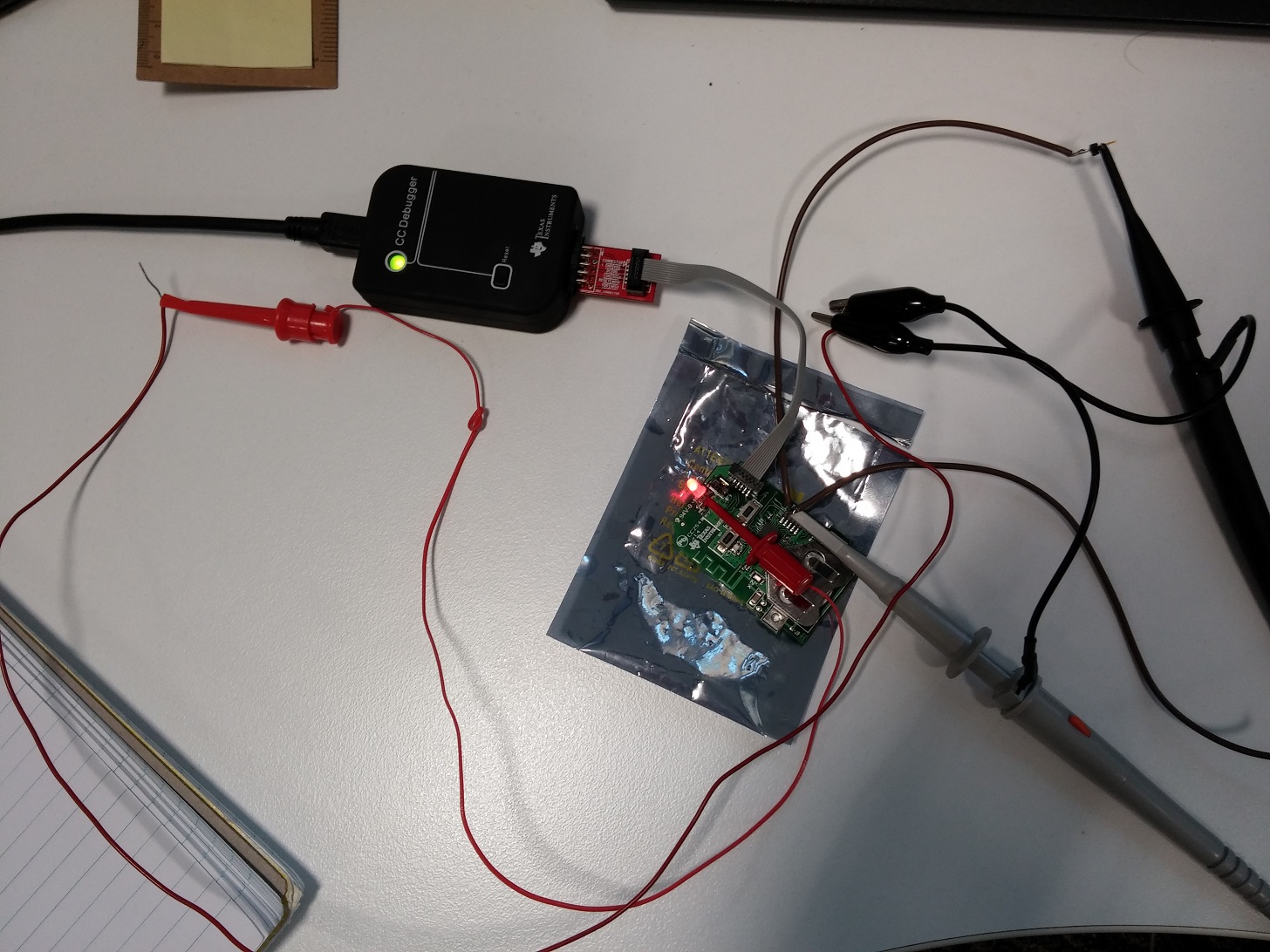

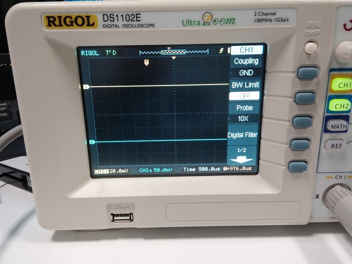

  • Hi Aslak,
    I'm measuring pins 2 & 4 on the Test pin bus which correlates to SCL/SDA according to the data sheet. I'm setting the I2C override mode into GPIO by setting it to 0x83 so both pins are in GPIO output mode. I'm clearing and setting the I2CIO flags continuously in a periodic function but I don't seem to be getting any changes on the signal end of things nor do I see any changes from GND. It's still the same parasitic noise for the SDA line and nothing for the SCL line. I've posted my setup here:
    I'm using the LED as a GND source since it's the only one available. The Keyfob is powered by the Debugger.

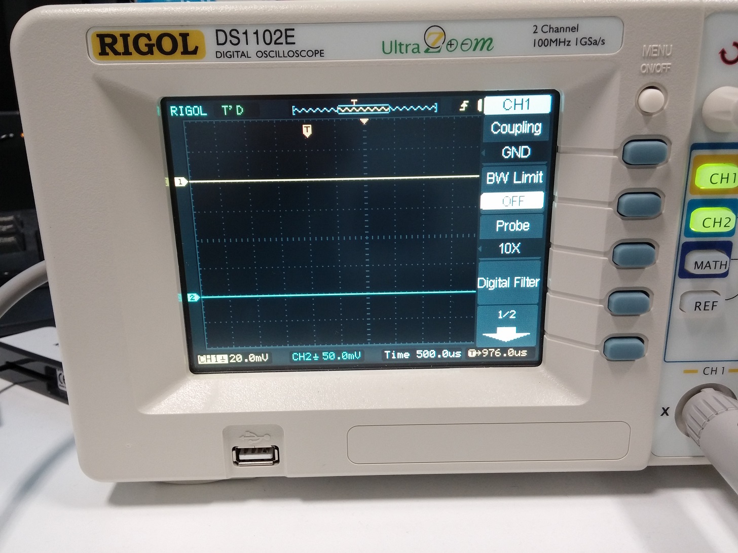

    Possibly parasitic noise from other pins on SDA. This occurs even with the I2C Module disabled...
    The GND measurement:
    Noct
