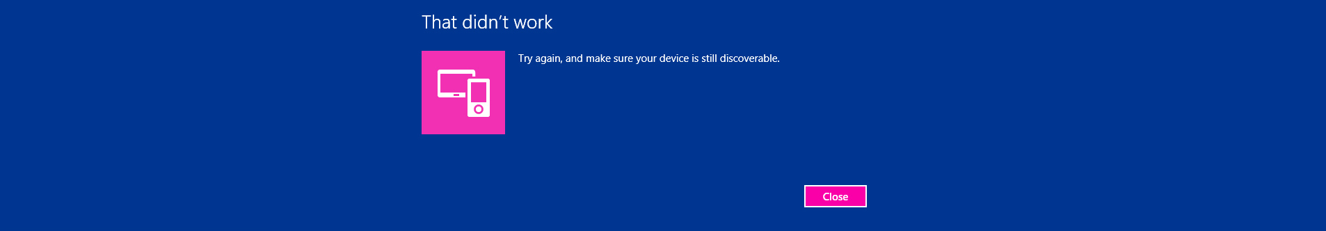

    My laptop has Bluetooth v 4.0 and actually is able to recognize the device CC2650STK. However, when I tried to pair up with it, my system said "it didn't work" in the Windows 8.1 Pro. Do you have any idea?
    If I have a Bluetooth Module 4.1 USB, would it be possible to read off sensor data from the laptop? I know TI has some HTML UI to perform that. If I was able to get the device paired up with my laptop, theoretically it will work right?

  • I finally found an answer, though I can't find confirmation that it's still true today:
    vincenth.net/.../building-cross-platform-ibeacon-apps-for-ios-android-and-windows-with-c-and-xamarin.aspx
    It turns out that Glenn was absolutely right, but let me clarify his answer. BLE has added support for a new pair-less connection, and it seems that the new SensorTag only supports this option by not implementing traditional pairing (though I would think that it should!) The connection is made directly to the GATT server. The idea was to keep power consumption low and skip the pairing overhead. Also it allows for "beacons", or devices that only send out data but don't need to establish pairing or to encrypt their data. (Think store advertisements to your phone as you're walking past.)
    This opens up two problem, though:
    1. Pairing establishes encryption keys. Without pairing, there's no encryption!
    2. The current Windows 8.1 BLE driver doesn't support pair-less connections. Period. I read somewhere that Windows 10 might. Do some google searches on "Windows BLE beacon support" and you can read all about it. Of course, Android, Linux, and IOS do.
    So until the SensorTag supports pairing or Windows releases pairless support, Windows users are SOL. THough I'm open to being proven wrong!

    I bought a USB device that has a full BLE stack and a programmable interface over a serial port, the BlueGiga BLE112. I bought it from Mouser for $20. Using it I've connected to the CC2650STK and scanned all of the values over GATT in Windows XP and 8.1. Finally. It isn't native BLE support, but it's useable! www.mouser.com/.../BLED112
