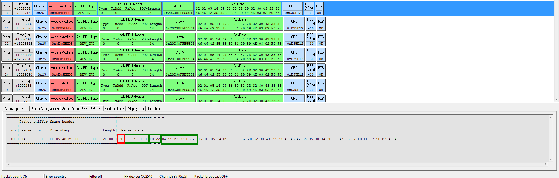

We're using a TI CC2540EMK-USB dongle for sniffing what is going on on the BLE radio interface when working with cc2650.
When looking at the Advertising we see the Access Address as expected (0x8E89BED6). Looking at the octet right in front of it, I expect to see the Preamble as 0x55 or 0xAA according to Core_v4.2.pdf. But the sniffer's GUI is displaying 0x2D instead. Everything else in the Advertising packet we can account for.
Does anyone have an idea what is going on?

  • Hi Tim,
    please find the requested screen shot attached.
    It has been produced with TI software that comes with the said USB dongle. Below is my interpretation, please do let me know what you think of it.
    Thanks.
    -- Frank.
    Field 'Length' is as expected: 2e 00
    Field 'Packet data'
    • 2D is where I've been expecting the Preamble 0x55 or 0xaa
    • D6 BE 89 8E is Access Address, a constant from Core Spec 0x8E89BED6
    • 00 22 seems to be Adv PDU Type and Adv PDU header
    • 04 55 FB 8F C3 20 is the AdvAddress
  • I believe this must be a length field, used internally in the packet sniffer. The packet sniffer does not really receive the preamble; as any other BLE receiver, it uses it for synchronization purposes.

    It is correct as was mentioned that this is a length byte added by the Packet Sniffer and used internally. This byte is not sent over air.  It holds the length of the data that follows it.
    Bjørn
  • Thanks Bjørn. Please see the SmartRF Packet Sniffer User Manual for more information: http://www.ti.com/lit/ug/swru187g/swru187g.pdf
