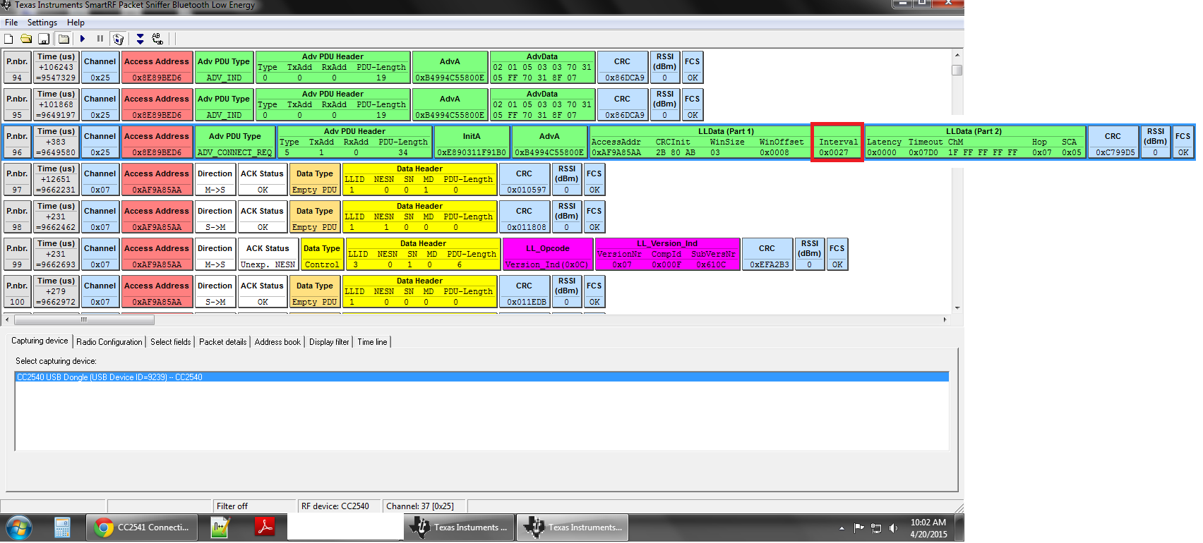

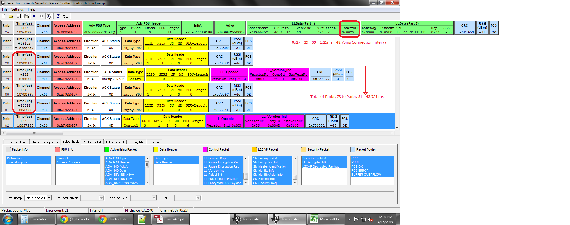

    Actually we took the air capture and observed the following:
    Our setup is like below:
    We are peripheral device. Ours is a custom application based on SimpleBLEPeripheral Code.
    We are connecting with Central Device.
    What we observed in this problematic case is that the Central Device sends the Connection Interval as 0x27 = 39 * 1.25ms = 48.75ms.
    We have configured "enable automatic parameter update request when a connection is formed" to TRUE.
    But our BLE Stack never triggers the "Connection Parameter Update Request" once the connection is established.

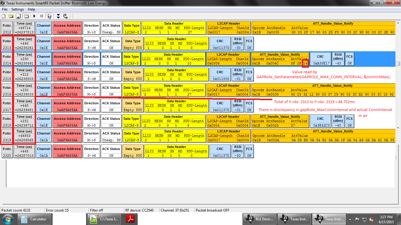

  • Hi JXS and Tim,
    As Tim suggested we added the below code at GAPROLE_CONNECTED state in peripheralStateNotificationCB():
    GAPRole_GetParameter(GAPROLE_MAX_CONN_INTERVAL, &connIntMax);
    if(connIntMax > 30)
    // Update connection parameters
    GAPRole_SendUpdateParam( 6, 20, 0, 1000, GAPROLE_NO_ACTION);
    We have also put the above same check in ProcessEvent() function in one of our Events which gets triggered every 2 seconds, so that we can trigger the Connection Parameter Update Procedure if Central Device exceeds the Connection Interval of 30 (i.e. 30 * 1.25ms).
    We are also logging the gapRole_MaxConnInterval, by sending it in the 3rd byte of our Data Service having the Attribute Handle  0x4C as shown in the below snapshot:
    As you can see from the above snapshot, although we have put code to trigger the Connection Parameter Update Procedure in our Data Event handled in the ProcessEvent() function, but the stack still does not trigger it.
    Also, it is observed that the gapRole_MaxConnInterval variable in peripheral.c file read by GAPRole_GetParameter(GAPROLE_MAX_CONN_INTERVAL, &connIntMax) is still showing 0x14 which is what is being set by Init() function, and when we call the GAPRole_SendUpdateParam().
    So we believe that somehow the stack is not triggering the Connection Parameter Update Request event though the application (Peripheral Device) is calling the GAPRole_SendUpdateParam() every 2 seconds and also the gapRole_MaxConnInterval variable is not getting updated of the current Connection Interval that is negotiated to 48.75ms.

  • Hi Sunny,
    How does the 3rd byte (highlighted) in the Notification packet correspond to the Connection Interval? Can you show a sniffer snapshot with the Connection parameter request and update sequence?
    Best wishes
  • Hi JXS,
    Please see the snapshot of the negotiated Connection Interval below:
    We have enabled the CONNECTION_EVENT from the BLE Stack via the below command:
    HCI_EXT_ConnEventNoticeCmd(TaskID, CONN_EVENT_COMPLETE_EVT);
    So on every Connection Interval we get the CONN_EVENT_COMPLETE_EVT event which we handle.
    In this CONNECTION_EVENT handling, we measure the time between two consecutive CONNECTION_EVENT.
    This measured time between two consecutive CONNECTION_EVENT should be the negotiated Connection Interval right ?
    The above time difference is being sent in the third byte of the notification packet.
    So in order to know the negotiated Connection Interval, we are logging the above mentioned time difference in the notification packet.
    Please do let me know if you require any other information regarding the same.
    All of your screen shots shows an initial conn interval of 0x27 (48.75ms), and you further indicated that the time delta between to consecutive CONN_EVENT_COMPLETE_EVT events is ~ 50ms. So far, this indicates correct operation as the conn interval is 48.75ms.
    What I think is the issue is you are querying the GAPROLE_MAX_CONN_INTERVAL but considering this value to be the actual conn interval; this is incorrect and only returns what you are requesting. If you want to check the current interval, query GAPROLE_CONN_INTERVAL parameter.
    Also, to cross-check, you should see GAPRole_SendUpdateParam() getting triggered on your debugger.

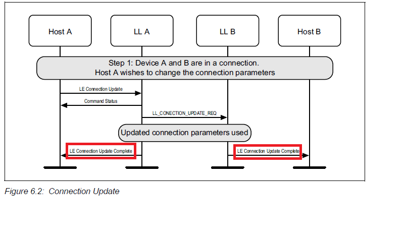

    On a leaving note, for the sake of clarity, as per the below diagram from the Bluetooth Core Specification v4.2:
    When the "LE Connection Update Complete" Event is sent from the Controller to the Host, the BLE Stack will call the GAPRole_RegisterAppCBs() function right ?
    And thus, the scenario of Connection Parameter Update Request sent from either Peripheral (we are Peripheral Device) or Central Device is handled by the GAPRole_RegisterAppCBs() function.
    Thanks again.
