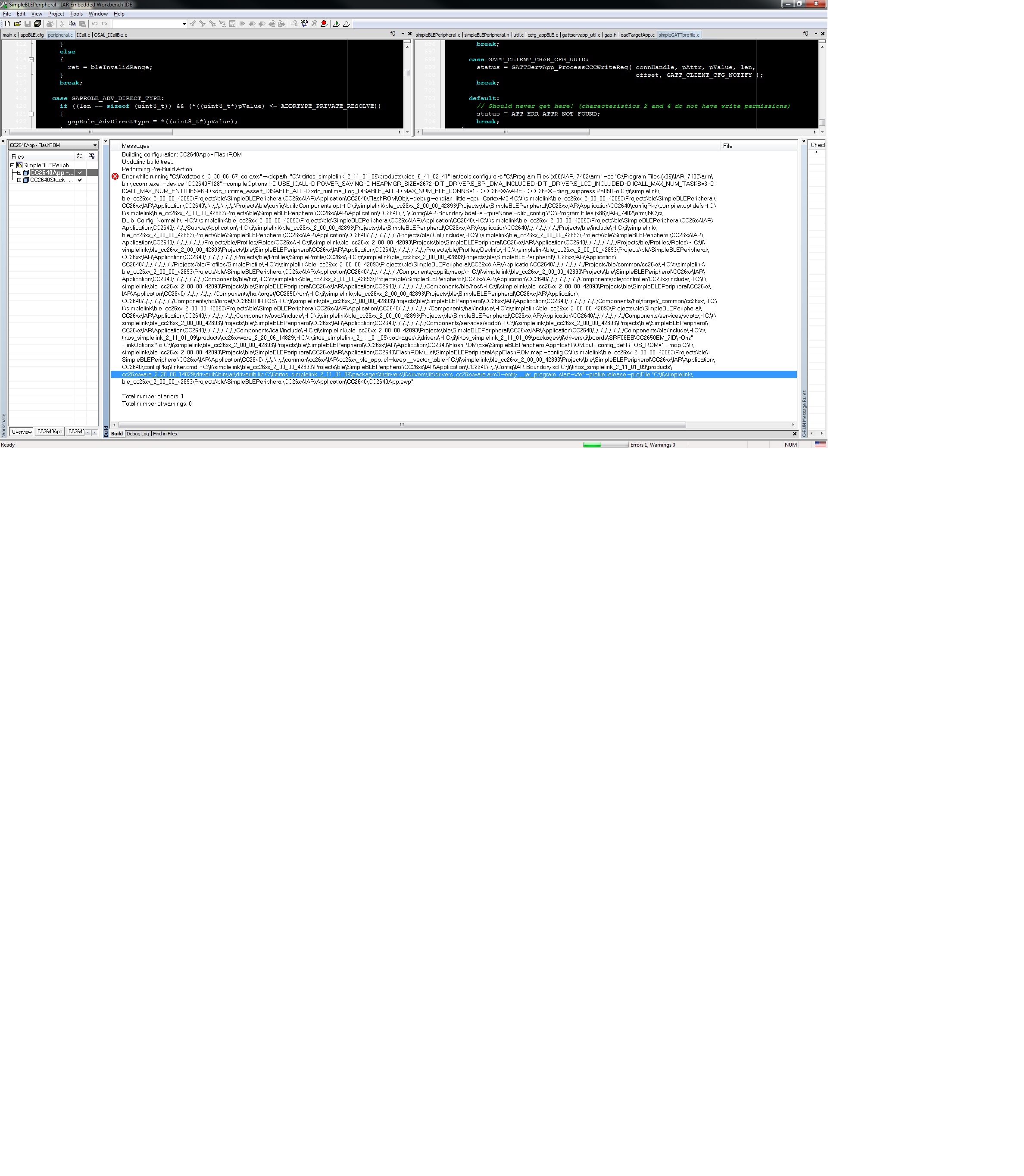

I'm trying to compile the SimpleBLEPeripheral Example for the CC2640. I'm getting the following problems when I build the "CC2640App - FlashRom" project.
There's a Error when performing the Pre-Build Action as shown below.
I'm using IAR ARM 7.40.2.8570.  The "CC2640Stack - FlashROM" project builds with no errors.
IAR Error - CC2640App - FlashRom

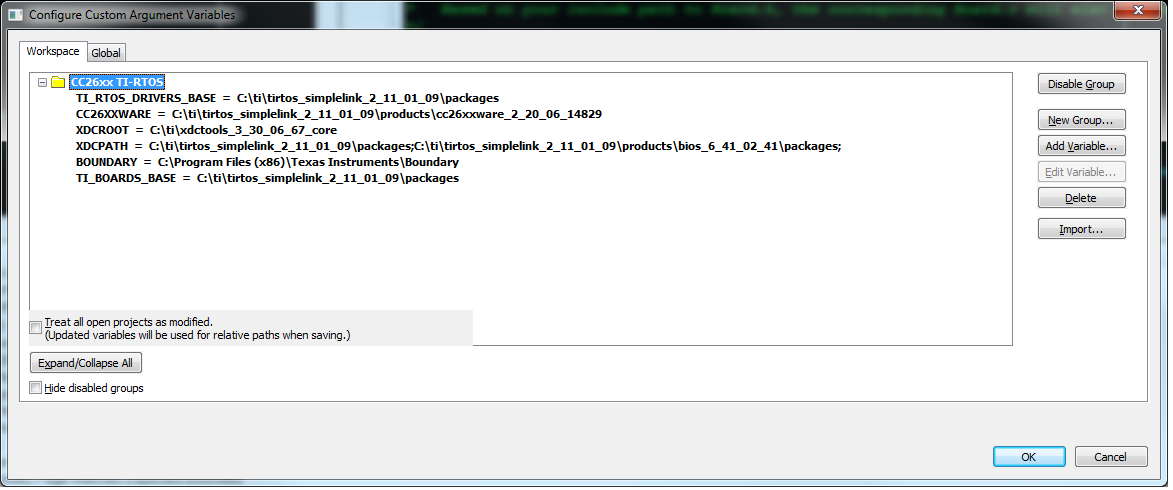

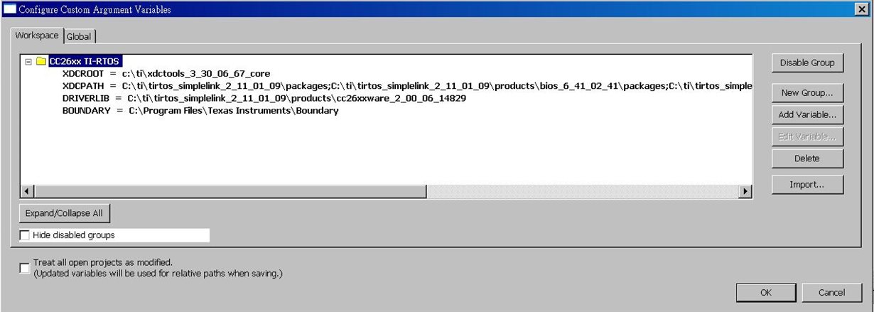

  • Your Custom Argument Variables looks weird. I suggest you remove them all and  go to IAR->Tools->Configure Custom Argument Variables and import C:\ti\simplelink\ble_cc26xx_2_00_00_42893\Projects\ble\SimpleBLEPeripheral\CC26xx\IAR\SimpleBLEPeripheral.custom_argvars.
  • Hi YiKai,
    I re-imported the SimpleBLEPeripheral.custom_argvars as you suggested and I'm still getting Pre-build error.
    Here's the SimpleBLEPeripheral.custom_argvars that I have installed.  It doesn't look the same as your picture. Specifically the "XDCPATH" is different from mine in your picture.

    I suggest first reviewing the Troubleshooting section of the CC2640 FAQ sticky thread. Can you attach your build log as a file after enabling "All" output. Also IAR ARM 7.40.2.8570 hasn't been tested with the SDK, can you try 7.30.4?
    Best wishes

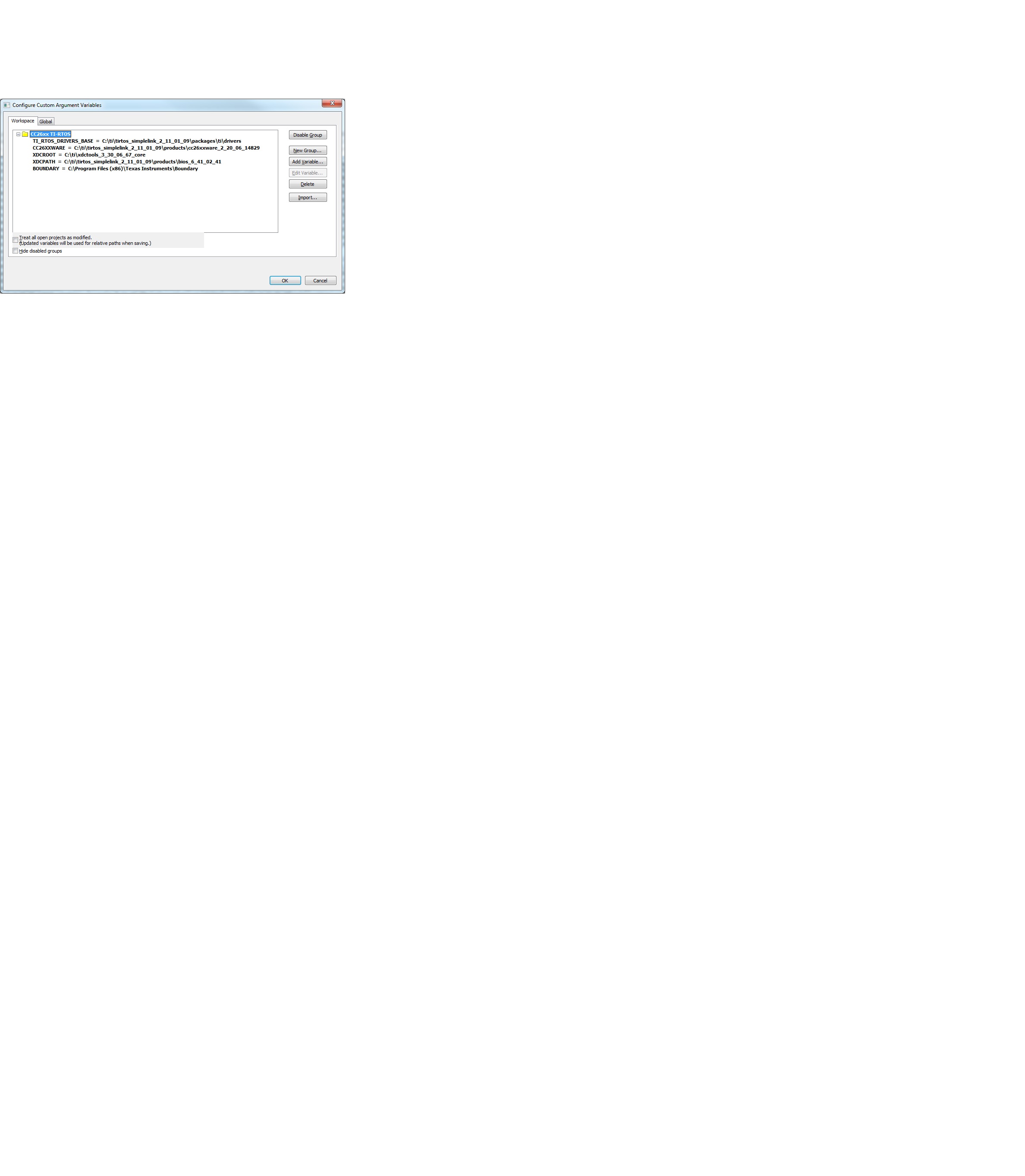

    I was able to get it to build but I had to do some modifications to the SimpleBLEPeripheral.custom_argvars after I imported it.
    I modified TI_RTOS_DRIVERS_BASE variable definition and I added the variable TI_BOARDS_BASE to correctly call out the path for the specific eval board I was using so that the project could find the Boards.h.
    I also attached my build output below.
    CC2640App-FlashROM_Build_Output.txt
    I also modified the include search paths in the IAR project as shown below.
