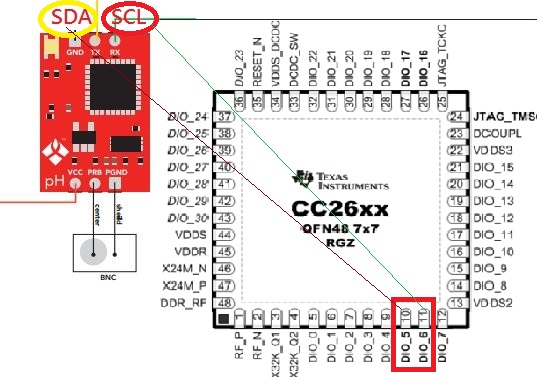

  • Hello Eirik:
    In fact , I really want to know that I2C sensor how to connect CC2650 . A couple of days ago, I have bought a PH sensor , PH sensor is I2C , now I am looking for I2C sample code . If you have similar sample code , please help me. Thank you. It very different between Arduino and Cortex-M3. I'm learning , even I follow Software Developer's guide , it's still a lot of problems when I Compiling sample code. For example , Software Developer's guide chapter 6.3.4 I2C , I do it , but it's not working.
    Look at the sensor controller studio example "I2C Light Sensor". It is very easy to understand and this code runs on the separate sensor controlelr processor (there are several processors inside CC2640, ARM coirtex M3 (32 bit) and custom low power sensor controller processor (16 bit)). Also check out the Sensortag project for how to interface to I2C sensors from the main application processor (CM3).
  • I don't have any SensorTag  can test ,   I have only one PH sensor run I2C :
    All I know is that PH's I2C address is 99.
  • No problem Tzuyu Lin,
    Simply connect the DIOs from the SmartRF06EB header pins to your sensor board. Look at the "I2C Light Sensor" project (sensorTag) for how to set up the I2C code on the sensor controller and check out "Analog Light sensor project" (SRF06EB+CC2650EM) too see how to set up your TI-RTOS project on the EB+EVM. I think you only need to change the board files to use the correct board files.
    C:\ti\tirtos_simplelink_2_14_02_22\packages\ti\boards\SRF06EB\CC2650EM_7ID
  • Can I use Flash Programmer 2 to burn SCS project "I2C Light Sensor" ? Because "I2C Light Sensor" code is easy to understand.
    I try to import "I2C Light Sensor" project to Code Composer Studio , but there are a lot of code that I don't understand.
    for Example, I don't know which file is define DIO pin ? All I can see is like this:
    only LED1 and LED2 was define , I can't find DIO6(SCL) and DIO5(SDA) pin define ? I guess it's maybe hide somewhere that I can't find it ?
    You can build and download the code through CCS (F11).
    The sensor controller framework will set up these two pins for you so you don't need to add them to any PinTable in your RTOS application. (this is done in scifTaskResourceInit which is automatically generated by SCS - do not modify).
