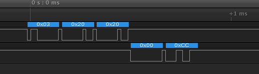

    Please also see the below example on how to use the boot loader with UART:

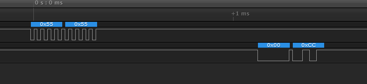

    Step 1: Write 0x55 0x55 to boot loader over UART. ACK from the bootloader is returned, baud rate is set automatically:
    Step 2 (optional to check connection is OK) Write CMD_PING to boot loader, ACK is returned

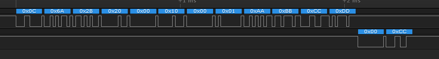

    Step 3 - write memory. Write 0xAABBCCDD to RAM address 0x20001000 (4kB offset from start of RAM). ACK is returned.
    Step 4: read memory. Read 4 bytes from RAM address 0x20001000.
    Step 5 - send ACK in return for package transmitted from the bootloader as response from the read command
    Svend

  • Hi Svend,
    yup, I thought so too, that tere is no need to wait indefinitely, until I tried to use this command.
    Just want to highlight that writing to flash works OK, then reading CRC32 of the stored flash image too, as presented on the screen shots below:
    Seding COMMAND_CRC32
    reception of ACK from boot and the calculated CRC32:
    Here is what I got while sending COMMAND_MEMOERY_READ right after COMMAND_CRC32 - reading from flash address 0x00000000:
    above command has been ACK-nowledged by the ROM-boot after ~12ms:
    and there is no response, even though I was sending zero byte indefinitely.
    This command reads from a specified memory mapped start address, therefore it should bepossible to read from flash, as it is possible to write there.
    Maciek

    I Like your waveform, but i have question about Step 3 and Step 4.

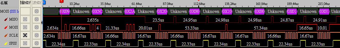

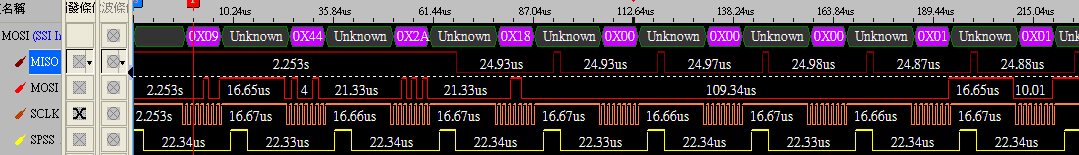

  • Hi Svend,
    Thank for your answered.
    but,
    The bootloader chapter of the TRM (SWCU117) have no complete information about COMMAND_MEMORY_READ
    Can i get more detail information about COMMAND_MEMORY_READ??
    Ex :
    The specified "Access Type" must be either 0 or 1.
    ____The value of 0 forces 8-bits read accesses.
    ____The value of 1 forces 32-bits read accesses.
    The specified "Number of Accesses" gives the number of 8- or 32-bits read accesses.
    ____Max value for Number of Accesses is 63 for Access Type = 1.
    ____Max value for Number of Accesses is ???? for Access Type = 0.
    Can i Read 256 Byte From Flash image by send once COMMAND_MEMORY_READ??
    what packet format of bootloader response ?? (about COMMAND_MEMORY_READ)
    I have trouble. (i use SSI Interface)
    When i Send COMMAND_MEMORY_READ to Bootloader :  09  5C  2A  20  00  10  00  01  01 (refer picture)
    i get Response : ACK (0xCC)
    and get Data : 06  49  5D  92  99  C1
    But, when i Send COMMAND_MEMORY_READ to Bootloader :  09  44  2A  18  00  00  00  01  01 (refer picture)
    i get Response : NACK (0x33)
    and get Data : 00 00 00 00 00 00
    Why can't i Read Address 0x18000000 Data ??
    Because the bootloader chapter of the TRM (SWCU117) account of that the flash starts at address 0x1800 0000(on CC26xx).
    so I need Download Flash image (*.Bin) to cc26xx (Start Addr 0x1800 0000) by bootloader,
    What different about   COMMAND_DOWNLOAD + COMMAND_GET_STATUS  and  COMMAND_MEMORY_WRITE??
    Best Regard,
    Miller
    This is not correct, we will have that fixed. The boot loader is partially re-used from CC2538 and it seems the documentation was not updated for the CC26XX. Sorry about that.
    Because 0x18000000 is not a valid address. Flash starts at 0x00000000, RAM starts at 0x20000000, peripherals start at 0x40000000.
    CMD_MEMORY_WRITE cannot write to flash but will only do direct accesses using the CPU. This means you can write to e.g. system SRAM, memory mapped peripherals etc.
    Svend

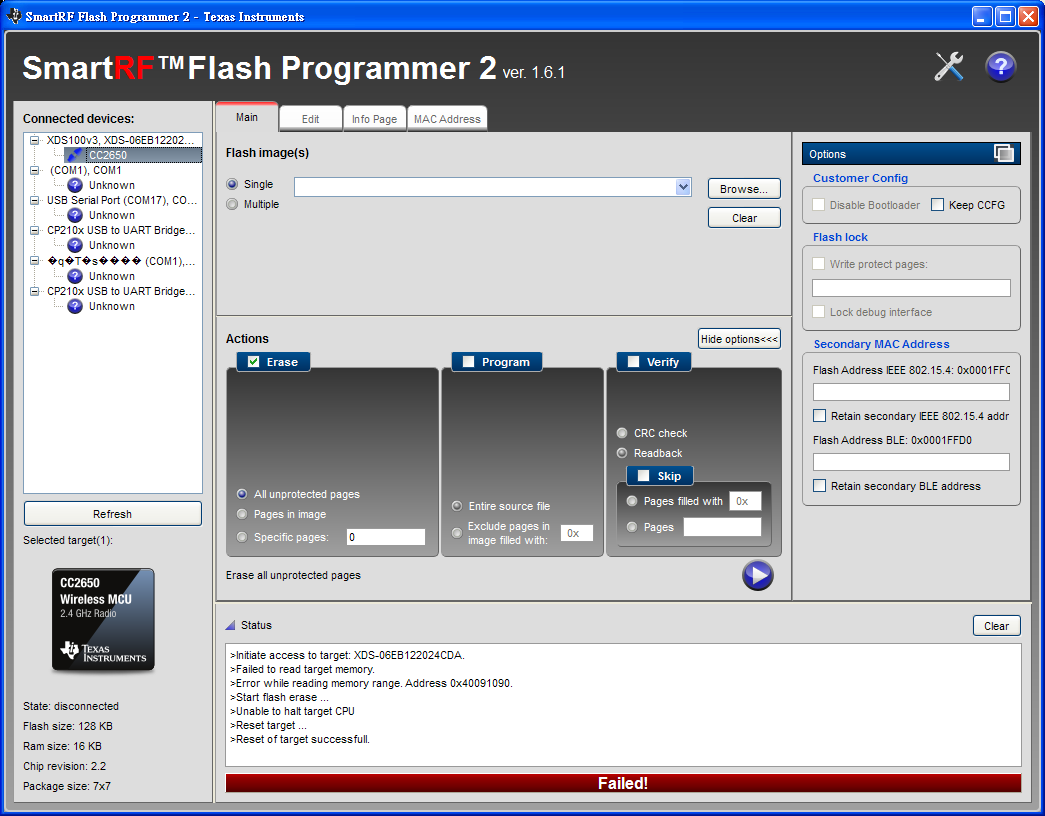

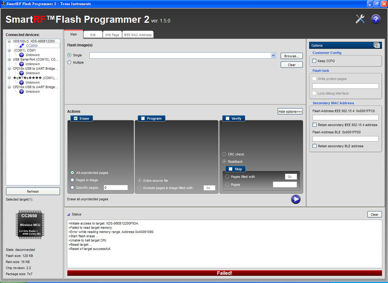

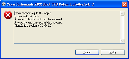

  • Hi svendbt,
    Thank you very much for your answers.
    But, i am having a big trouble now.
    When i Follow this operational process:
    Step 1. Send COMMAND_READ_MEMORY to Read Flash Data (0x0000 0000~0x0001 FFFF), and saved as "A File (*.Bin, 128KB)".
    Step 2. Send COMMAND_Bank_Erase to Erase Flash.
    Step 3. Send COMMAND_DOWNLOAD + COMMAND_SEND_DATA to Download  "A File (*.Bin, 128KB)"  to Flash (0x0000 0000~0x0001 FFFF).
    Then, CC2650 did not respond any information, even ACK and NAK.
    i try to used SmartRF Flash Programmer 2 1.5 to erase Flash, But was Failed.
    Status :
    >Initiate access to target: XDS-06EB12200F93A.
    >Failed to read target memory.
    >Error while reading memory range. Address 0x40091090.
    >Start flash erase ...
    >Unable to halt target CPU
    >Reset target ...
    >Reset of target successfull.
    And Then, i try to used CCS6.1.0 to debug (download), i get Failed Information.
    i found that i maybe set All CCFG to 0x00 (0x0000 0000 ~ 0x0001 F000), When i send COMMAND_DOWNLOAD + COMMAND_SEND_DATA.
    i guess that is why error happened.
    How can i rebuild cc26xx ??
    When i send COMMAND_READ_MEMORY to Read Addr 0x0001 D000~0x0001 DFFF,
    Why is i always get different data at fragmentary Address??
    Best Regard,
    Miller
  • Can you try updating to the latest Smart RF Flash Programmer 2 (v1.6) and test again? Also, make sure you have the physical reset pin connected to the debugger for Halt-In-Boot to work properly.

  • Hi Svend,
    i used SmartRF Flash Programmer 2 (v1.6) to erase Flash again, But was still Failed.
    (i try to implement at other SmartRF06 Evaluation Board that are same fail )
    Status :
    >Initiate access to target: XDS-06EB122024CDA.
    >Reset target ...
    Just Like You Said.
    if i fill in Flash (0x0000 0000 ~ 0x0001 F000) with correct Data; but fill in CCFG with zeroes (0x0001 F000 ~ 0x0001 FFFF),
    (When i send COMMAND_DOWNLOAD + COMMAND_SEND_DATA.)
    Then, the Cortex M3 will trigger a Hard Fault exception and consequently go into lockup.
    This is means that the cc26xx was can't do anything even download flash imgae??
    Can i rescue cc26xx from Failed??  if yes, How??
    Best Regard,
    Miller
