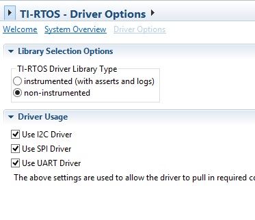

I made sure I selected "Use I2C Driver" in the RTOS cfg file.

  • Hello. Yes, that change does appear necessary. Does the I2C work if you do not initialize UART and SPI? The code from the document is an extremely basic example. There are other considerations to take into account when adding multiple drivers. There is also a much more in-depth example of I2C in the SensorTag proejct.
  • I2C_open typically returns null if it is already opened or if the PIN_open inside the driver is not getting a pin handle for the pins it wants to use.
    This can happen if some other peripheral drivers already has taken ownership of the pins using PIN_open or if the application has done this.
    Make sure you don't use the same pins for many purposes in the board files.
    You can add the I2C source file to your project and set a breakpoint in the driver to easier see what is going on. Files:
    C:\ti\tirtos_simplelink_2_11_01_09\packages\ti\drivers\I2C.c
    C:\ti\tirtos_simplelink_2_11_01_09\packages\ti\drivers\i2c\I2CCC26XX.c
