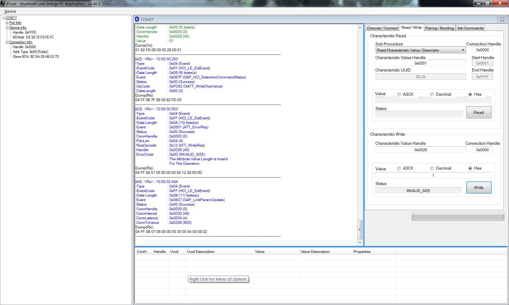

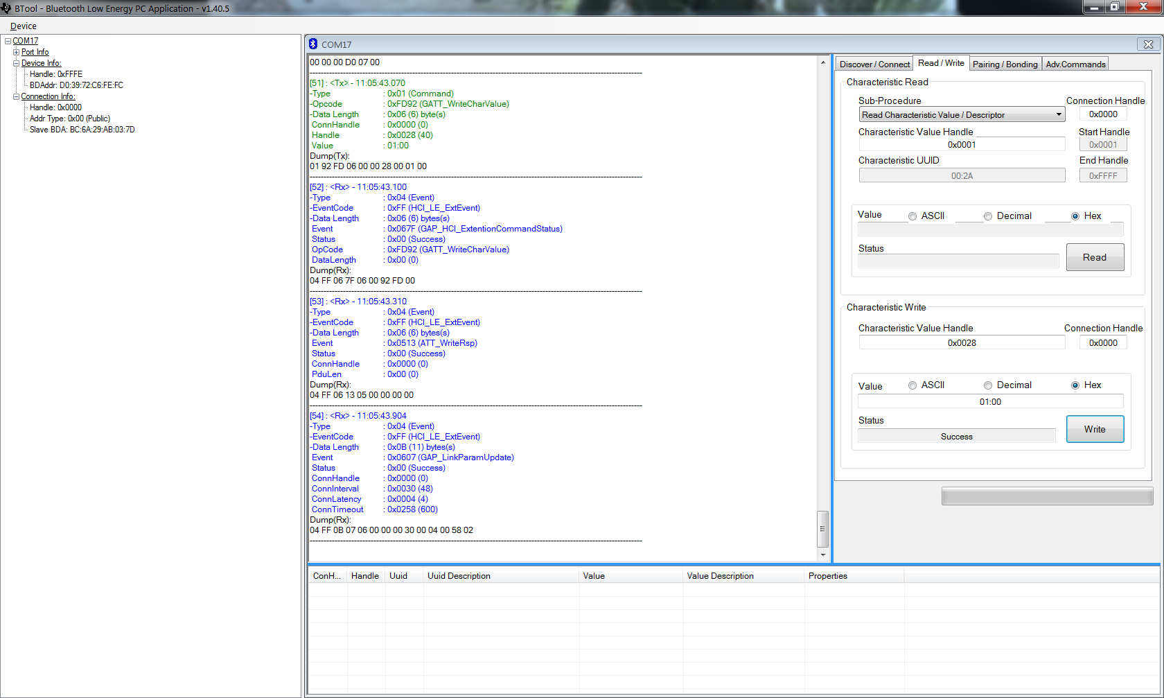

I am new to the CC2541 DK and I am currently following the  User guide just to see how it works. I am following the instructions to sound the Buzzer of the KeyFob under the Immediate Alert Service using the BTool. I have been successful in scanning and establishing connections, as well as writing to the Characteristic handle 0x0028 with the value 01:00. I receive a "Success" status, but the buzzer does not sound. Also when I change the value 00:00 or 02:00, I get an invalid parameter report back.
Before I start digiing into code and trying to understand how it works, I just want to run it according to the User guide. Can you help?
