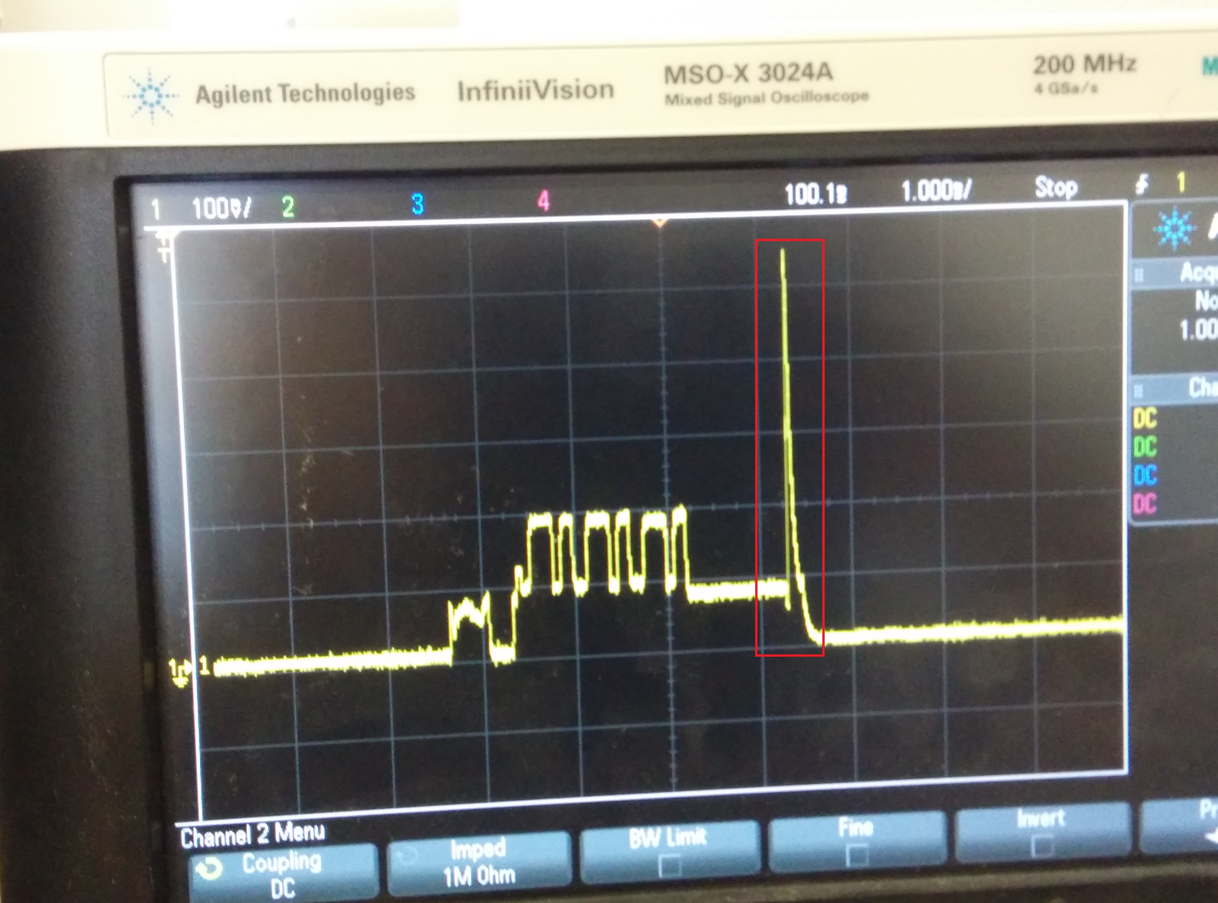

I was trying to make some current consumption measurements, the I came up with a strange behavior.
The firmware core of my application is based on the Keyfob sample project that comes with the TI BLE Stack. Using the keyfob considering the recomendations from application note AN092 ( http://www.ti.com/lit/an/swra347a/swra347a.pdf ) and programmed with this firmware, if I look e.g. for the advertising packet, I have something like this:
It shows this current consumption peak at the end of the adv packet with a maximum value of circa 55 mA (a 10 ohm resistor at the input is used, so the value read with the oscilloscope is divided by 10). Both my custom firmware and the raw provided Keyfob firmware present this behavior. This current peak occurs everytime that the CC2541 goes to sleep mode (PM2), so it also happens, for example, when a connection event is sent and when I check the battery level.

  • Hi Jose,
    Since you have followed the keyfob design I assume you are using the TPS62730 regulator? If so, the current peak is caused by the regulator going into bypass mode when the CC2541 goes to PM2. When that happens the VDD net is switched from 2.1 V to your supply voltage (3.0 V?) and the current peak is caused by the charge-up of the decoupling caps.

  • Hi Jose,
    It is hard to avoid the current peak when you switch the supply voltage to the CC2541 (with its decoupling caps) from 2.1 to 3 V. If this is not acceptable in your application you can consider using the TPS62740 instead. That regulator does not switch to bypass in LPM due to the ability to maintaining high efficiency for uA loads. You will increase the sleep current by a couple of uA though.

  • Hi Gabriel,
    The current peak is expected due to the regulator output switching from 2.1 V to the battery voltage (~3 V). I would recommend mounting the 47 uF cap.

  • Hi all,
    We got an update. We have tested the exactly same firmware on a CC2540 MINI-DK and on a CC2541 MINI-DK. The CC2541 has drained the battery way faster than the CC2540, which contains no TPS meaning no current peaks. The CC2541 does have a 47uF cap mounted on it which is supposed to smooth those current peaks. Question: May it be that 47 uF is not enough? Please give us a feedback on that issue. We are suspicious that such current peaks are decreasing battery capacity. Have you ever heard of any other similar issue?
    Gabriel
  • Hi Gabriel,
    That is interesting results! To answer your last question first, we have not received any similar feedback before. However, I do agree that current peaks can be a killer for coin cell batteries.
    One thing you can do as a final confirmation is to run the same SW on the CC2541 keyfob, but with the DCDC regulator forced to bypass.
    If the current peaks turns out to be the problem, I would add more capacitance, as you suggest, maybe also with a small resistor between the battery and the cap. An alternative, as I recommended above, is to use the TPS62740 instead as this does not switch to bypass when the CC2541 goes to sleep.
    Fredrik
  • Hi Fredrik,
    Thank you for your prompt reply. I will do the test you suggested bypassing the TPS62730. I am not sure our application allows us to use TPS62740 since it would increase current consumption while in sleep mode. We just mounted a 100 uF tantalum cap on the board and the peaks have considerably decreased. However, I have got two questions for you:
