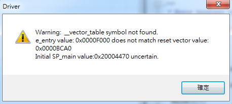

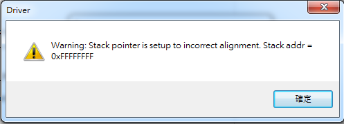

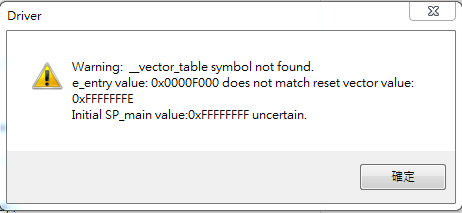

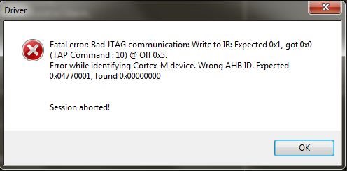

Debugging
"Warm" resets of the MCU domain only are no longer supported and the HW will convert them to a full reset equivalent to a pin reset. This causes the device to lose contact with the debugger.
When debugging the device and you want to reset the recommended way of doing this is using the "Board reset" option. This option makes the debugger reset the device with a pin reset and then halts the CPU before any user code is executed.
