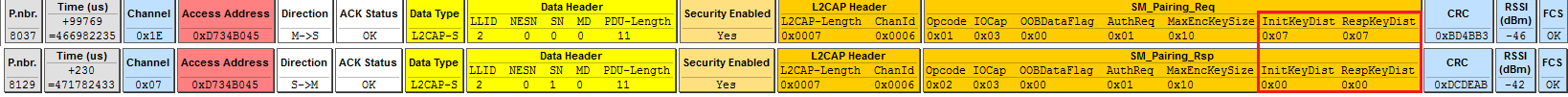

I have two scenarios for pairing devices, a instant pairing and pairing prompt that delays. The instant works correctly, but the delay does not. I see the same data being passed into:
static void gapBondMgrAuthenticate( uint16 connHandle, uint8 addrType, gapPairingReq_t *pPairReq )
but I see in the Packet Sniffer:
The Working one has the same values in the SM_Pairing_Req and SP_Pairing_Rsp for both KeyDist feilds (0x07). The Failing one does not (0x07 & 0x00).
It looks like those values should come from the keyDist object, but that is always filled with 1's. So I'm not sure how the (0x07) is generated.
  • I tried forcing the values and it still fail's:

  • Hi Josh,
    Can you provide details on how you are doing "pairing prompt that delays"? Also, what is the other device? Another CC2540 or smartphone, etc.?
    Best wishes
  • One device is a cc2540 the other is a cc2541.
    All I am doing is Saving the Pairing Detail on a GAP_PAIRING_REQ_EVENT:
    gapPairingReqEvent_t *pPkt = (gapPairingReqEvent_t *)pMsg;
    pPairReqVal = pPkt;
    then the user can trigger it to respond later:
    linkDBItem_t *pLinkItem = linkDB_Find( pPairReqVal->connectionHandle);
    gapBondMgrAuthenticate( pPairReqVal->connectionHandle, pLinkItem->addrType, &(pPairReqVal->pairReq) );
  • Hi Josh,
    I'm not sure what's going on. Can you provide a patch showing the condition with the delay?
    Best wishes
  •     case GAP_PAIRING_REQ_EVENT:
