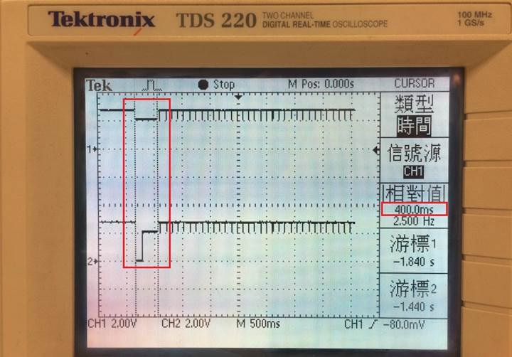

Hi TI Partners,
There our customer has encountered a issue about the Power Mode from PM3 to Active.
And they referenced TPS62730 design for their CC2541 Product,
But they found the issue of latency what should be Active 400 mS then turn to PM2 for Advertising.
Thus, I'm tried to use TI Official BLE Stack 1.4.0 for duplicated that, The symptom exist.
Please kindly check test result with Attachment and help to clarify it why.
Many Thanks.
TI_BLE_1.4.0_Official.rar

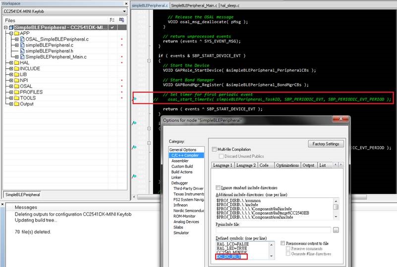

H/W : CC2541 Keyfob With TPS62730
S/W : SimpleBLEPeripheral ( Defined “DC_DC_P0_7” And Disabled “SBP_PERIODIC_EVT” )
Purpose  : Using right button for trigger Advertising and measuring Power Level.
CH1. : CC2541 Keyfob Voltage Level ( CR2032 )
CH2. : CC2541 Keyfob Right Button
