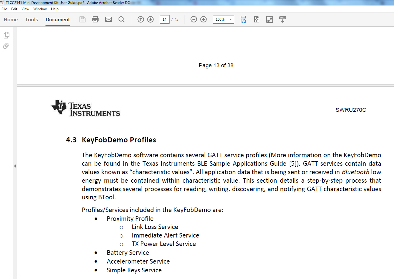

    1. As can see from the User Guide: KeyFobdemo is being used as the basic pre-installed software inside CC2541DK-MINI. I want to download back the keyfobdemo inside the keyfob and usb dongle. But seriously I cant, there is no more red light advertising and even green light on when battery is inserted or taken out. I checked the voltage of battery. It is 3.3V and can still light up an LED.

  • 1. Do you rebuild KeyFobDemo and download it to Keyfob?
    2. You have to plug USB dongle to USB port to give it power.
    3. I suggest you to study KeyFobDemo and get familiar with BLE stack first. When you have some experience on it, you will know how to modified it.
