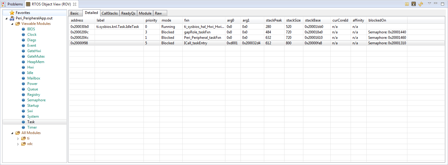

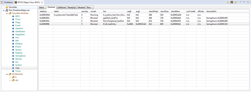

  • Hi again,
    I tried this morning something different, I removed the sensor controller functions and only increments a static value between the connection event: The system does crash as before !
    Here are the tasks when crashed, the Idle Task is running and everything is blocked... it seems that the stack size is not the problem.
    Any help is welcome
