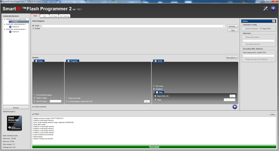

    • After some iterations repeating the steps indicated in the previous point, we found that we can not load the flash image, also we can not read or write in the internal flash. Trying to recover board using "Forced Mass Erase Option" gives a similar error message, as seen in following screen capture:

  • The logging feature uses a lot of RAM so you easily end up with some stack overflows but you should be able to erase the device still.
    Can you verify that the reset signal connected all the way to the chip? When uploading flash to the device the debuggers resets the device and then toggles TCK to make the boot ROM stop the CPU before TI RTOS starts up and disables JTAG again.
    To exclude either the SW or the board it would be great if you can test with our SimpleBLEPeripheral example. Remove TI_DRIVERS_LCD_INCLUDED as compiler preprocessor and change the BoardGpioInit table in the Board file to match your setup.
    Svend
