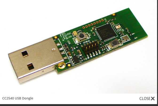

I wasn't able to locate Pin 1 of USB Dongle 2540. I searched through forums and certain documents. There is no specific information. To be noted
I require it in order to rightly connect the cable from CC Debugger to USB Dongle.

You can check Figure 44 CC2540 USB Dongle and Figure 45 CC2540 USB Dongle Connected to CC Debugger in CC2540 and CC2541 Mini Development Kit User's Guide.
