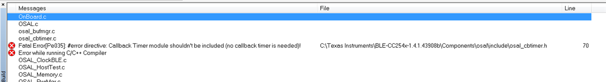

    I tried using your defines and got linking errors. One of them had to do with the OSAL_CBTIMER, and after adding that in, I got some other linking error. So I'm using my original preprocessor setup, replicated below:
    INT_HEAP_LEN=2700
    HALNODEBUG
    OSAL_CBTIMER_NUM_TASK=1
    xPOWER_SAVING
    HAL_AES_DMA=TRUE
    HAL_DMA=TRUE
    HAL_UART=TRUE
    HAL_UART_DMA=TRUE
    HAL_UART_ISR=0
    HAL_UART_SPI=1
    HAL_SPI_QUEUED_TX=TRUE
    HAL_KEY=FALSE
    HAL_LCD=FALSE
    HAL_LED=FALSE

  • Hello Tim,
    I follow the preprocessor settings you propose for the HostTest - CC2540SPI BUT I get the following error:Could you please help me ?
