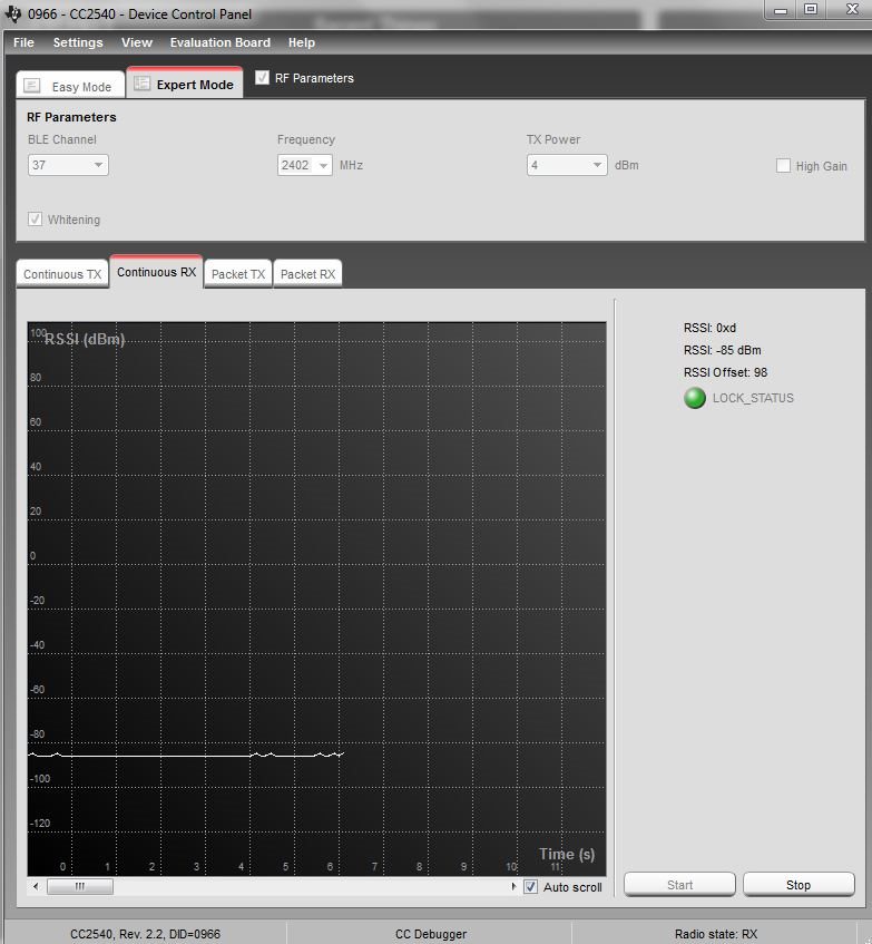

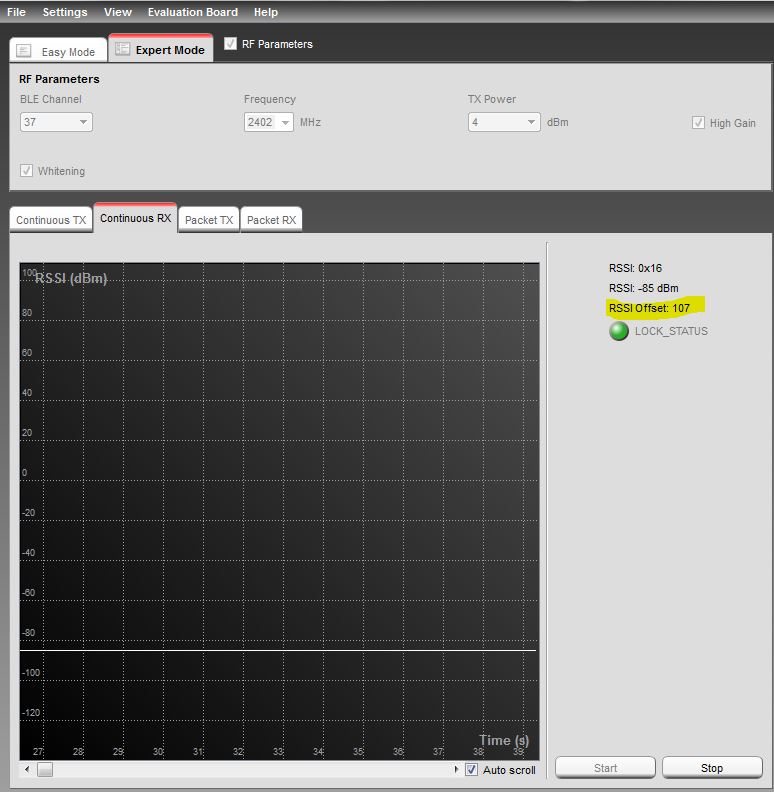

I was trying to taking some continuous TX/Rx measurements using two CC254x + RF05 Boards using attached via SMA cable with series attenuation.  To see the effect of the High Gain Setting.
Both captures were taken on the same RF05 board, the Transmitter board was set to 0 dBm for both captures.
Can you please explain the difference between RSSI (hex), RSSI (dBm) and RSSI Offset.  It appears that the RSSI (dBm) stays the same despite the High Gain being checked or not.
Without High Gain Checked:
With High Gain Checked:
