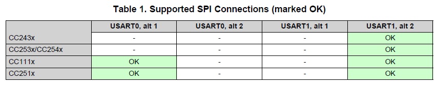

hi i've made a custon pcb based on keyfob schematic project, so i've used usart0 alt1.
but now reading the ccdebugger manual i've seen that:
All of the current TI RF SoCs can be configured to operate as SPI slaves, with the SPI signals (CS, SCLK,
MISO and MOSI) going to one of the USART peripherals. The packet sniffer application programs the
SoC with firmware that configures one of the USART peripherals in order to communicate with the CC
Debugger. The firmware can use any of the four possible pin configurations (USART 0 or 1, pin out
alternative 1 or 2). However, only a subset is currently supported (see Table 1).
but in this table is specified that ccdubugger+pcb based on cc2541 support only usart1 alt2.
How i can use the packet sniffer with ccdubugger + pcb based on keyfobproject?
