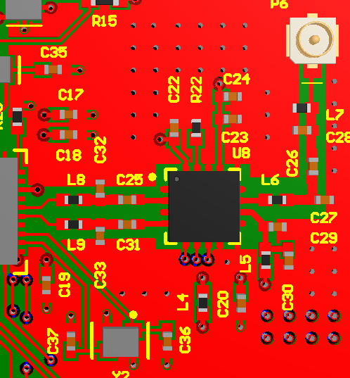

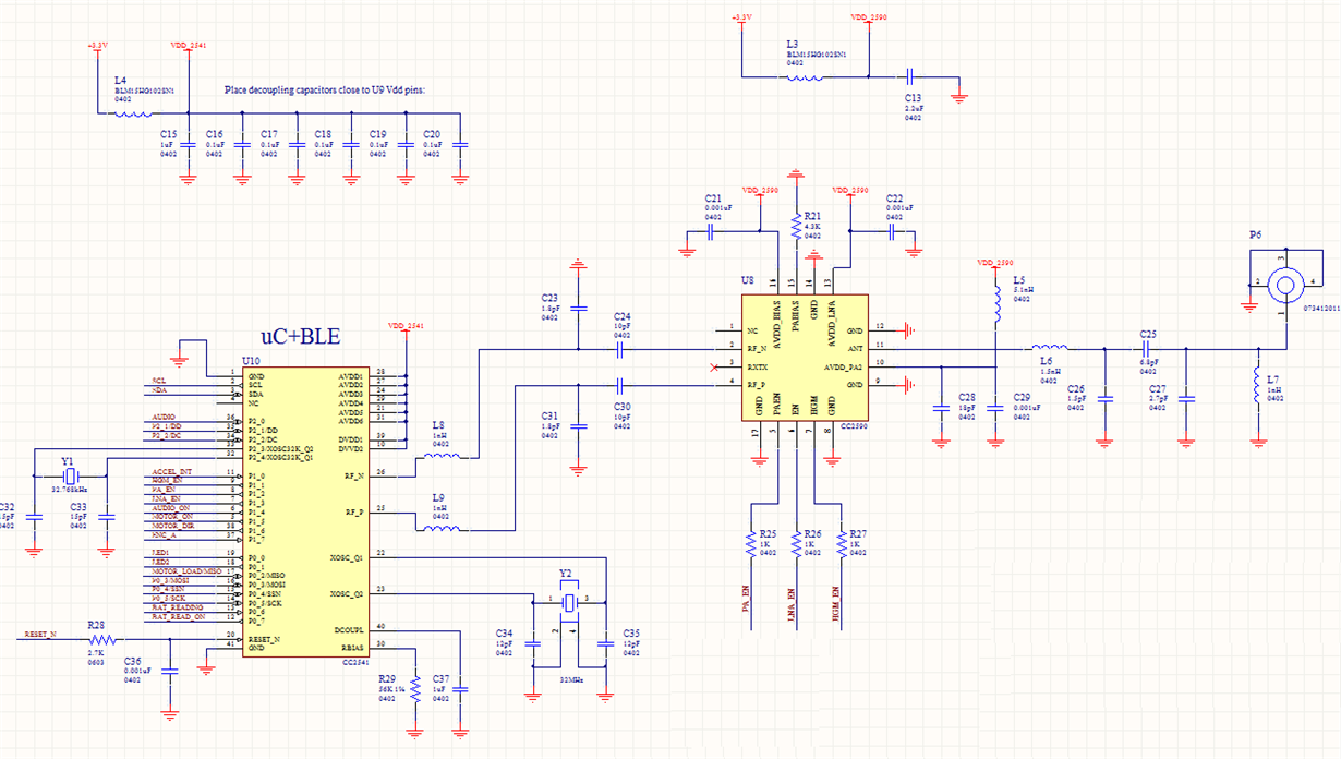

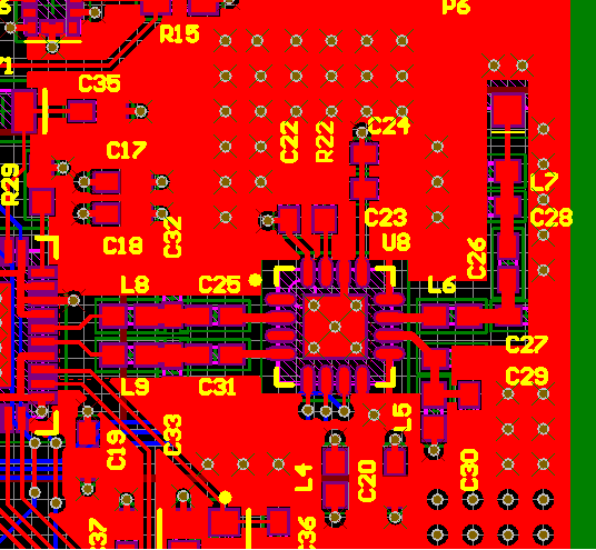

    Could you please advise regarding my layout and the use of a UFL connector, images are below.
    Schematic Part
    Layout 3D View
    Top Layer
    Layer View
    Any input regarding this layout would be greatly appreciated!
    Thank you,
    Blair Fredericks
  • Hi Blair,
    The layout looks good. I would expect this to work very well.

    Yes I am using the same control pins as in your reference design, my schematic is included.

    I wanted to change my design so that I make a 90 degree turn right at the antenna pin, not a few parts in.
    I have see I few designs, they are doing this?
